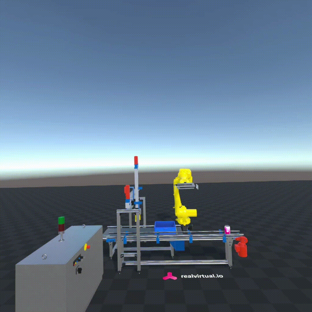

<figure><img src="https://260262196-files.gitbook.io/~/files/v0/b/gitbook-x-prod.appspot.com/o/spaces%2FpYxFg97YnJX96UzNNTSd%2Fuploads%2Fgit-blob-b2cc9e443bd705ce49d9a7dcd00687ca68f17a3e%2FVideoprojekt%201.gif?alt=media" alt="" width="563"><figcaption><p>Some of the basic VR functionalities</p></figcaption></figure>

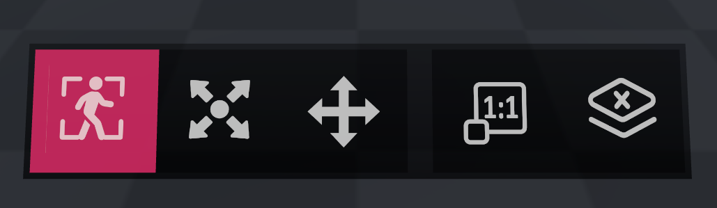

  \ <img src="https://260262196-files.gitbook.io/~/files/v0/b/gitbook-x-prod.appspot.com/o/spaces%2FpYxFg97YnJX96UzNNTSd%2Fuploads%2Fgit-blob-266c427665ececf7e08cf8b4110a1826a585d11c%2FScreenshot%202024-03-06%20041728.png?alt=media" alt="" data-size="original">\
  The user can switch between 3 operational modes allowing either to navigate in the scene or to reposition placeable objects. Placeables are a special type of object that can be moved, rotated and scaled in VR and AR at runtime. For further information on placeables please refer to\
  \ <img src="https://260262196-files.gitbook.io/~/files/v0/b/gitbook-x-prod.appspot.com/o/spaces%2FpYxFg97YnJX96UzNNTSd%2Fuploads%2Fgit-blob-a16532c832d2dcd289cb158ebb68623141b218cc%2Fwalk.png?alt=media" alt="" data-size="line"> In the navigation mode, the user can move around the scene and rotate the view using the thumbsticks on the controllers.\
  \ <img src="https://260262196-files.gitbook.io/~/files/v0/b/gitbook-x-prod.appspot.com/o/spaces%2FpYxFg97YnJX96UzNNTSd%2Fuploads%2Fgit-blob-ca11ae790db57c7ab42c4b39ec3d4a8feba88ec3%2Fplacemesh.png?alt=media" alt="" data-size="line"> In the scene placement mode, the user can pick placeable objects and place them on predefined scene meshes. Any game object in the layer **rvSceneMesh** having a collider is recognized for placement.\
  \ <img src="https://260262196-files.gitbook.io/~/files/v0/b/gitbook-x-prod.appspot.com/o/spaces%2FpYxFg97YnJX96UzNNTSd%2Fuploads%2Fgit-blob-fad3dd3bd78527ea4cf651da875c761b49c4ac2b%2Fplacefree.png?alt=media" alt="" data-size="line"> In the free placement mode, the user can pick placeable objects and place them freely. The picked object follows the players hand movement. This mode allows high precision placements.\
  In both placement modes, the controller thumbsticks can be used to rotate and scale the object during placement.\
  Further buttons and toggles enable additional features:\
  \ <img src="https://260262196-files.gitbook.io/~/files/v0/b/gitbook-x-prod.appspot.com/o/spaces%2FpYxFg97YnJX96UzNNTSd%2Fuploads%2Fgit-blob-ec802b55b008a725d11d3b92ecc0a47843a5a529%2Fscale1.png?alt=media" alt="" data-size="line"> This button resets the scale of each placeableobject in the scene.\
  \ <img src="https://260262196-files.gitbook.io/~/files/v0/b/gitbook-x-prod.appspot.com/o/spaces%2FpYxFg97YnJX96UzNNTSd%2Fuploads%2Fgit-blob-f85e7f4c0bb7812252be52e0a78663a3eb07a1cd%2Fhide.png?alt=media" alt="" data-size="line"> This toggle hides or shows a predefined overlay object. This feature is used to quickly toggle some parts of the scene.\

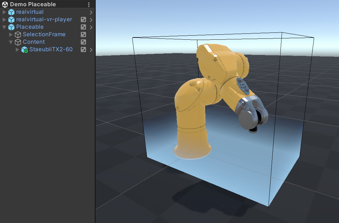

The **SelectionFrame** marks the selectable area for picking by the user. The **Content** object holds the actual placeable content.
To add a new placeable object simply drag the Placeable prefab into your scene. Add all the gameobjects that sould be affected by this placeable as children under the **Content** game object.
<figure><img src="https://260262196-files.gitbook.io/~/files/v0/b/gitbook-x-prod.appspot.com/o/spaces%2FpYxFg97YnJX96UzNNTSd%2Fuploads%2Fgit-blob-f454ba0eedd8f106a83b992822e3cae824f750ba%2FScreenshot%202024-03-06%20065643.png?alt=media" alt=""><figcaption><p>Sample setup of a placeable object</p></figcaption></figure>
Optionally you can select the SelectionFrame game object and press the recompute button to recompute the bounds of the selection area. To preview the selection area activate the **Visual** child game object of SelectionFrame.
