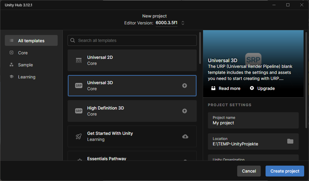

1. Open **Unity Hub** and click **New project**.
2. Select **Universal 3D** under Core templates to use the Universal Render Pipeline (URP).
3. Set a project name and choose a location for the project folder.
4. Ensure **Editor version 6000.3** (Unity 6.3 LTS) is selected.
5. Click **Create project**.

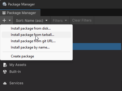

After downloading, install the packages in Unity:
1. Open **Window > Package Manager**.
2. Click the **+** button in the top-left corner and select **Install package from tarball...**.

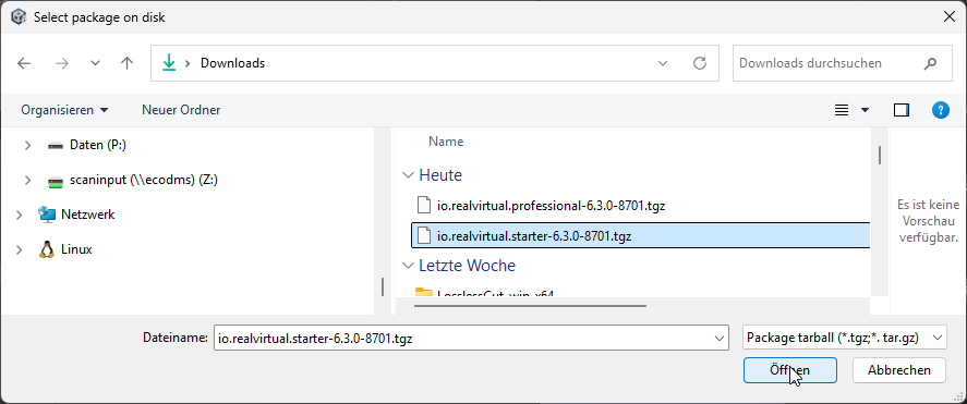

<figure><img src="https://260262196-files.gitbook.io/~/files/v0/b/gitbook-x-prod.appspot.com/o/spaces%2FpYxFg97YnJX96UzNNTSd%2Fuploads%2Fgit-blob-bb40eef4a031da0e7a3ef65f885491f8c73a886a%2Finstallation-63-install-from-tarball.png?alt=media" alt="" width="375"><figcaption><p>Install package from tarball in Package Manager</p></figcaption></figure>
3. Navigate to the downloaded `.tgz` file and select **io.realvirtual.starter** first.

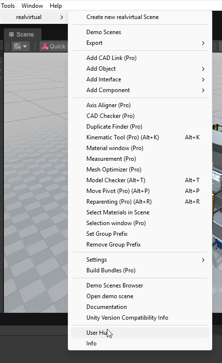

After installing the packages, the **realvirtual** menu appears in the Unity menu bar. Use the built-in **User Hub** to manage updates:
1. Go to **Tools > realvirtual > User Hub** in the Unity menu.

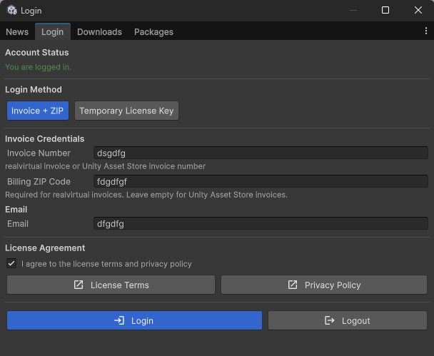

2. In the **Login** tab, enter your **Invoice Number**, **Billing ZIP Code**, and **Email**. Click **Login**.

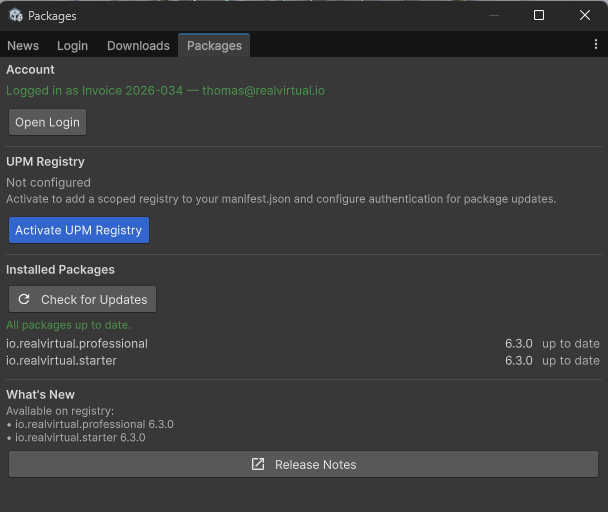

**Activate UPM Registry (Recommended)**
To receive automatic update notifications, activate the realvirtual UPM Registry:
1. In User Hub, go to the **Packages** tab.
2. Click **Activate UPM Registry**.
<figure><img src="https://260262196-files.gitbook.io/~/files/v0/b/gitbook-x-prod.appspot.com/o/spaces%2FpYxFg97YnJX96UzNNTSd%2Fuploads%2Fgit-blob-8e3b4c636354ef2c4ab58b57e158a36e9667e102%2Finstallation-63-userhub-packages.png?alt=media" alt="" width="375"><figcaption><p>Activate UPM Registry in the Packages tab</p></figcaption></figure>

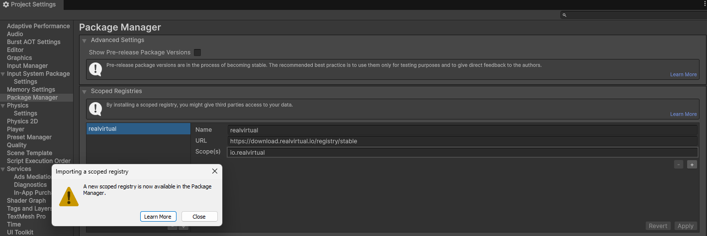

3. Unity will add a scoped registry to your **Project Settings > Package Manager** and show a confirmation dialog.
<figure><img src="https://260262196-files.gitbook.io/~/files/v0/b/gitbook-x-prod.appspot.com/o/spaces%2FpYxFg97YnJX96UzNNTSd%2Fuploads%2Fgit-blob-8b928afe385a79e33cbfcc9debb5071f29a48076%2Finstallation-63-scoped-registry-dialog.png?alt=media" alt=""><figcaption><p>Scoped registry added to Project Settings</p></figcaption></figure>
4. Future updates will now appear automatically in the Package Manager under **My Registries**. Use **Check for Updates** in User Hub to verify.

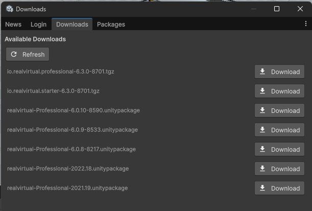

Alternatively, you can download newer versions from the **Downloads** tab in User Hub (or from the Customer Portal) and install them via **Install package from tarball** as described above.

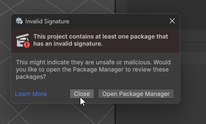

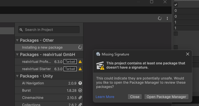

### Step 4: Handle Signature Warnings
{% hint style="warning" %}
When installing packages from the Customer Portal or User Hub (not from the Asset Store), Unity may show a **Missing Signature** or **Invalid Signature** warning. This is expected — realvirtual packages distributed outside the Asset Store are not Unity-signed. It is safe to click **Close** and continue.
<figure><img src="https://260262196-files.gitbook.io/~/files/v0/b/gitbook-x-prod.appspot.com/o/spaces%2FpYxFg97YnJX96UzNNTSd%2Fuploads%2Fgit-blob-f1e517ba925704e10092eedebd71a7361ee24a42%2Finstallation-63-missing-signature.png?alt=media" alt="" width="563"><figcaption><p>Missing Signature warning — safe to close</p></figcaption></figure>
<figure><img src="https://260262196-files.gitbook.io/~/files/v0/b/gitbook-x-prod.appspot.com/o/spaces%2FpYxFg97YnJX96UzNNTSd%2Fuploads%2Fgit-blob-27a689c67fba25c219882513b4bcb6fdb100207a%2Finstallation-63-invalid-signature.png?alt=media" alt="" width="375"><figcaption><p>Invalid Signature warning — safe to close</p></figcaption></figure>

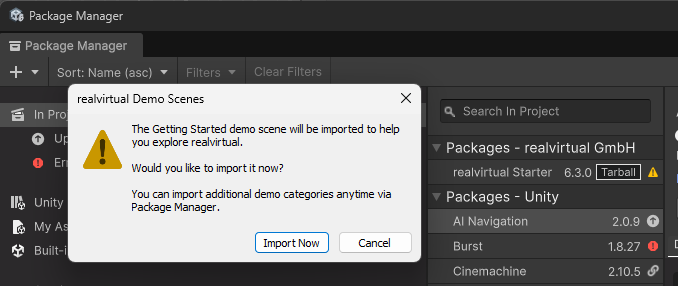

After installation, a dialog will ask if you want to import the **Getting Started** demo scene. Click **Import Now** to get started right away.
<figure><img src="https://260262196-files.gitbook.io/~/files/v0/b/gitbook-x-prod.appspot.com/o/spaces%2FpYxFg97YnJX96UzNNTSd%2Fuploads%2Fgit-blob-789a124a79b20b608ae930c1a404b4dd0a891950%2Finstallation-63-demo-import-dialog.png?alt=media" alt="" width="375"><figcaption><p>Import the Getting Started demo scene</p></figcaption></figure>

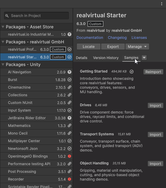

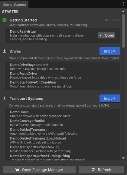

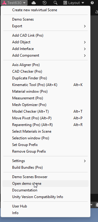

You can import additional demo categories at any time using two methods:
**Via Package Manager:** Select **realvirtual Starter** (or Professional) in the Package Manager, go to the **Samples** tab, and click **Import** for the demo categories you want.
<figure><img src="https://260262196-files.gitbook.io/~/files/v0/b/gitbook-x-prod.appspot.com/o/spaces%2FpYxFg97YnJX96UzNNTSd%2Fuploads%2Fgit-blob-daa1cfff30545e7e0e6459ac5d12498fa7518d6a%2Finstallation-63-package-samples.png?alt=media" alt="" width="375"><figcaption><p>Import demo scene categories from the Samples tab</p></figcaption></figure>
**Via Demo Scenes Browser:** Go to **Tools > realvirtual > Demo Scenes Browser** in the Unity menu. This window shows all available demo scenes organized by category with descriptions.
<figure><img src="https://260262196-files.gitbook.io/~/files/v0/b/gitbook-x-prod.appspot.com/o/spaces%2FpYxFg97YnJX96UzNNTSd%2Fuploads%2Fgit-blob-b991e4925ffea2fcb740233821c3e6838e0ef601%2Finstallation-63-open-demo-menu.png?alt=media" alt="" width="375"><figcaption><p>Open Demo Scenes Browser from the realvirtual menu</p></figcaption></figure>
<figure><img src="https://260262196-files.gitbook.io/~/files/v0/b/gitbook-x-prod.appspot.com/o/spaces%2FpYxFg97YnJX96UzNNTSd%2Fuploads%2Fgit-blob-1dc2b31fb91f58a3a71072b03e1e6a4933852b6a%2Finstallation-63-demo-browser.png?alt=media" alt="" width="375"><figcaption><p>Demo Scenes Browser with categories and scene descriptions</p></figcaption></figure>

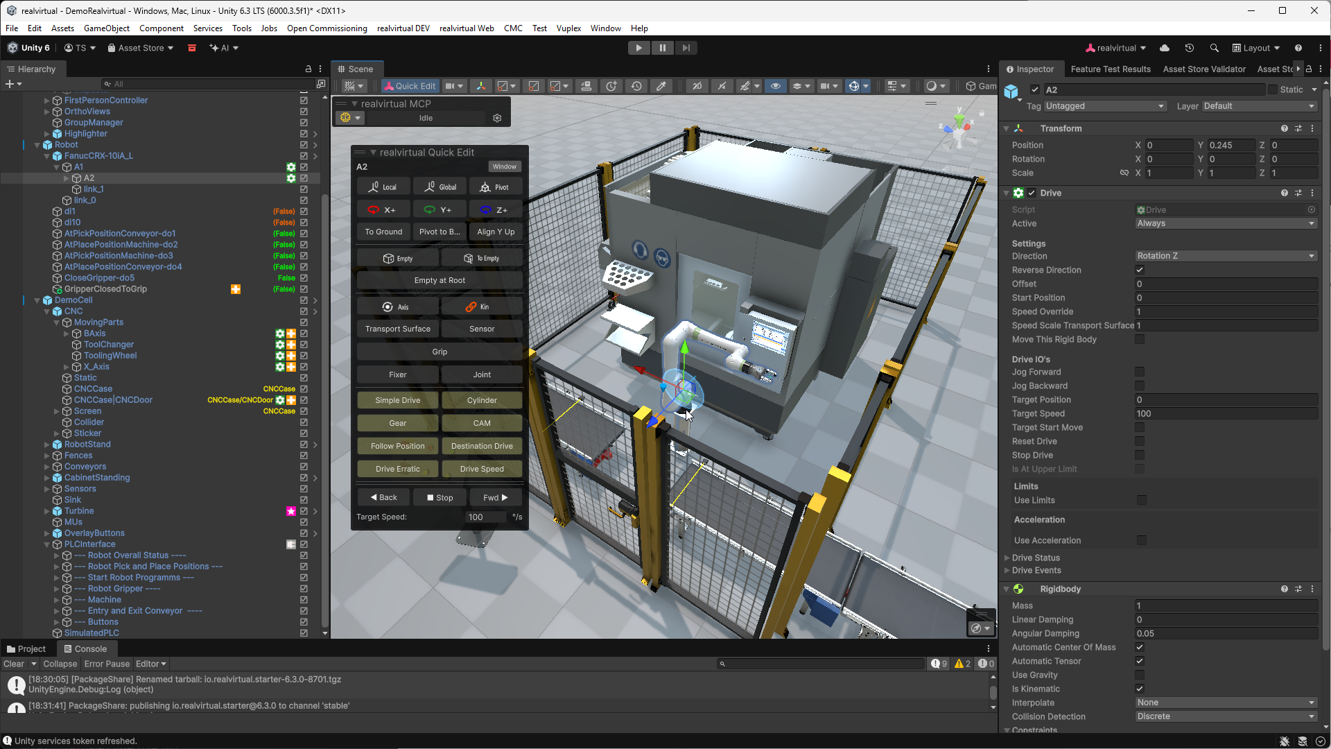

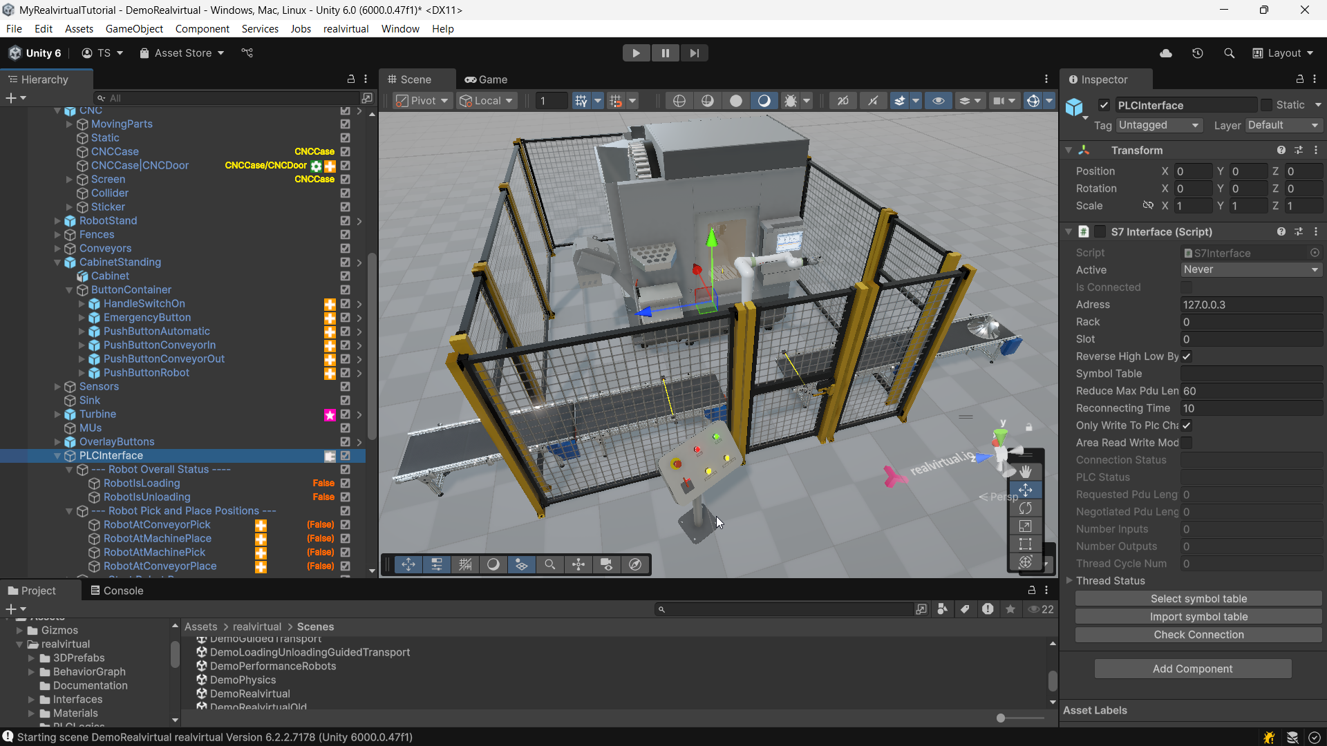

### Step 6: Explore the Demo Scene
The Getting Started demo scene opens automatically after import. It showcases a complete automation cell with conveyors, a robot, sensors, and a machine — all working together.
<figure><img src="https://260262196-files.gitbook.io/~/files/v0/b/gitbook-x-prod.appspot.com/o/spaces%2FpYxFg97YnJX96UzNNTSd%2Fuploads%2Fgit-blob-0b50d6ff6cd9afdf5502af2073722ec252484adc%2Finstallation-63-demo-scene.png?alt=media" alt=""><figcaption><p>realvirtual 6.3 demo scene</p></figcaption></figure>
Press **Play** in the Unity Editor to start the simulation and see the automation in action.

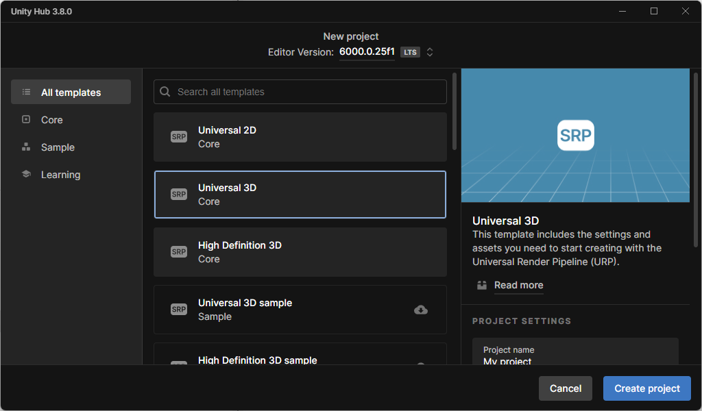

### Step 2: Create a New Unity Project
1. Open **Unity Hub**.
2. Select **Universal 3D** under Core templates.
3. Ensure **Editor version 6000.0 LTS** is selected.
4. Click **Create Project**.

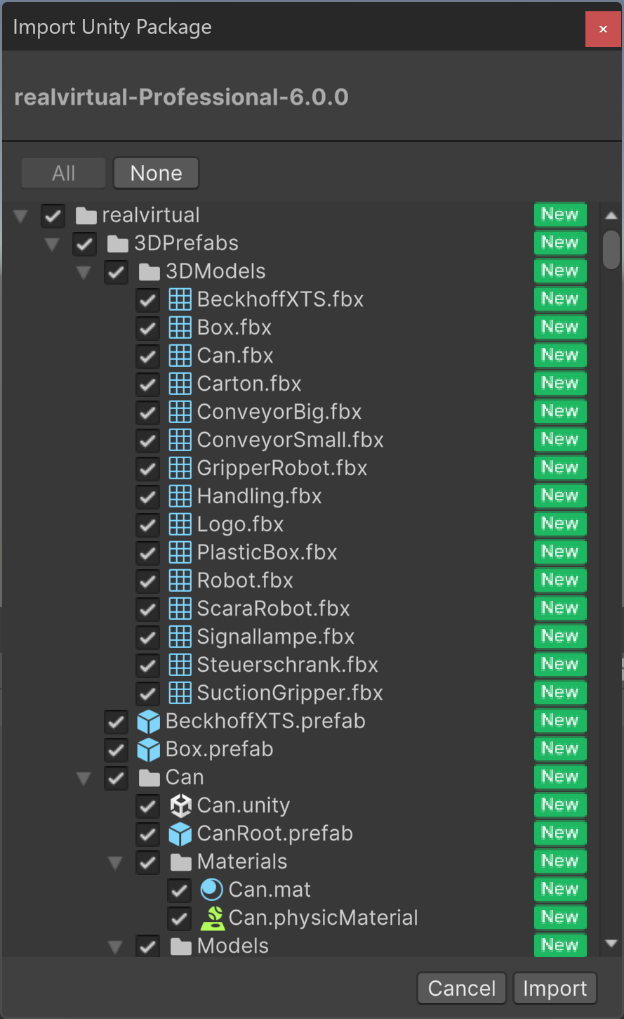

  1. Download the `realvirtual.unitypackage` file from your account on the realvirtual.io download website.
  2. Drag and drop the file into the Unity Project window, or go to **Assets > Import Package > Custom Package**.

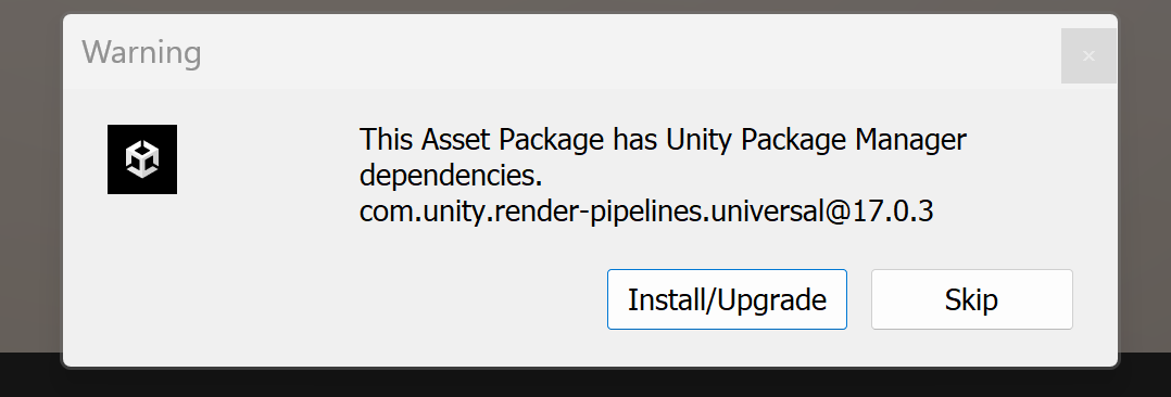

When prompted about a **URP Upgrade**, select **Install / Upgrade**.

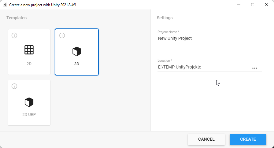

### 3. Create a New Project
Launch Unity and create a new empty project by selecting "New." Choose a location on your computer to store your project files and give your project a name. Then, click "Create Project."
When prompted to choose a template, select the standard 3D template. This will form the foundation of your project:

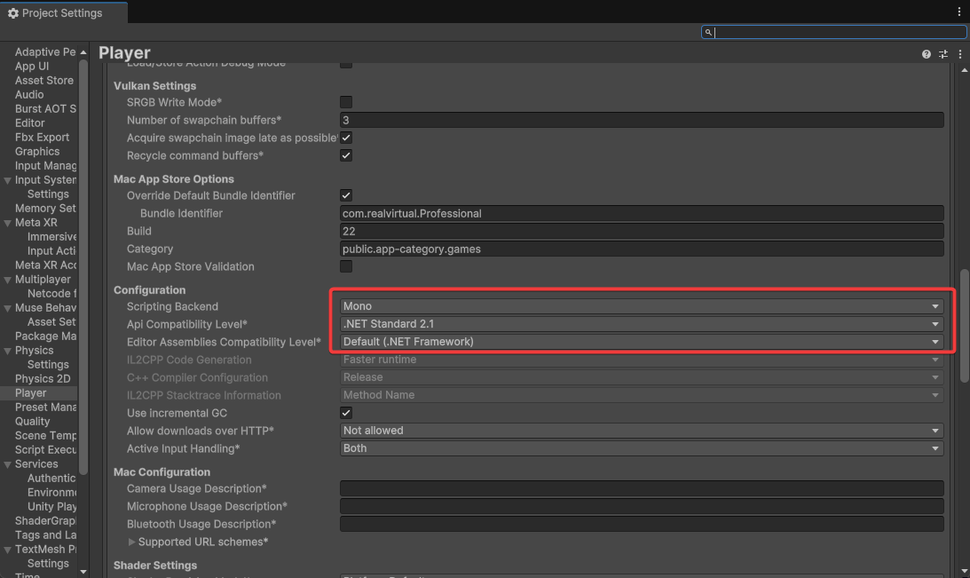

### 5. Ensure .Net Standard Framework 2.1 and Mono are Enabled
By default, Unity should have .Net Standard 2.1 and Mono enabled. However, in some cases, especially when integrating realvirtual.io into an older project, this setting might be incorrect. To confirm or change this setting:
* Go to Player Settings by selecting "Build Settings" > "Player Settings."
* Under "Configuration," change the Scripting Runtime Version to ".NET Standard 2.1"
For the scripting backend, it's recommended to start with Mono rather than IL2CPP, as Mono typically compiles much faster.

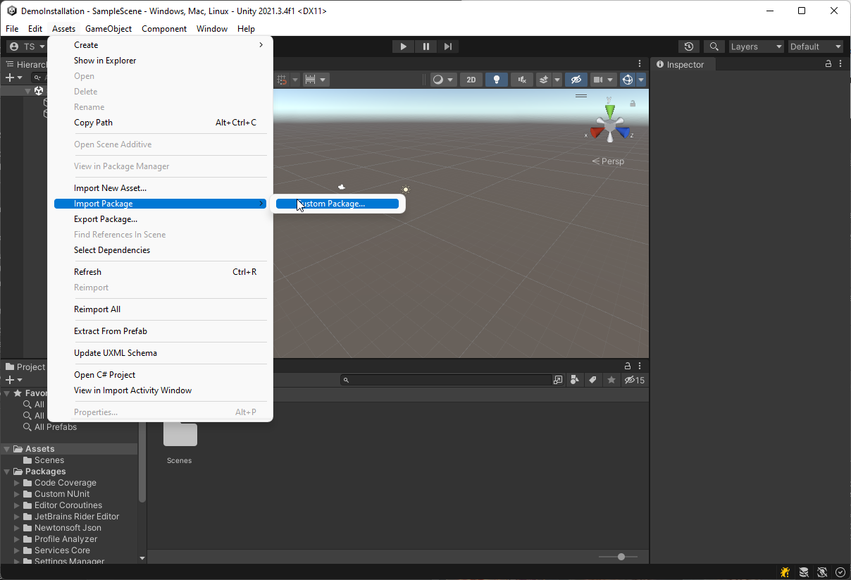

### 7. Import realvirtual.io
You can import realvirtual.io directly from the Unity Asset Store or manually download the asset. To install it manually, follow these steps:
* From the main menu, go to "Assets" > "Import Package" > "Custom Package..."
* A new window will appear, displaying the contents of the realvirtual.io package. Select "All" and click "Import."

This will show a new window with all the realvirtual.io package contents:
![](https://260262196-files.gitbook.io/~/files/v0/b/gitbook-x-prod.appspot.com/o/spaces%2FpYxFg97YnJX96UzNNTSd%2Fuploads%2Fgit-blob-58509931e3b0c11cb2c6cbdcf613755a36cac7b4%2Fimage.png?alt=media)
Please select *All* and *Import*.

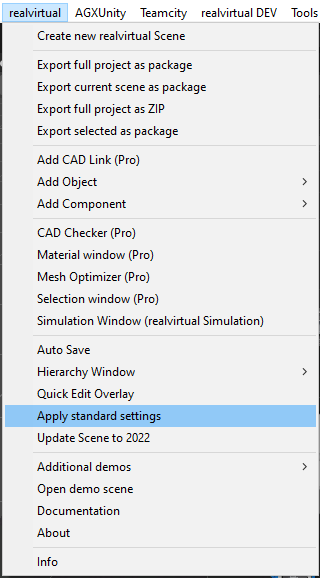

### 8. Verify Installation
After importing the realvirtual.io package, check for the following:
* You should see an additional "realvirtual" folder (previously "game4automation" before 2022) in your project structure.
* A new "realvirtual" menu should be available in the main menu bar.
<figure><img src="https://260262196-files.gitbook.io/~/files/v0/b/gitbook-x-prod.appspot.com/o/spaces%2FpYxFg97YnJX96UzNNTSd%2Fuploads%2Fgit-blob-a178ea87b555df407bed026aeee002055f32c2a3%2Fdemoscene.png?alt=media" alt=""><figcaption><p>Project view after realvirtual.io installation</p></figcaption></figure>
### 9. Set Standard Settings
Usually, standard settings are applied automatically after a fresh installation or update of realvirtual.io. However, if you encounter compile errors in the console window, it may be due to conflicts between your existing project assets and realvirtual.io.
In such cases:
* Address the compile errors first to ensure there are none remaining.
* Once errors are resolved, apply the standard settings by selecting "realvirtual" > "Apply Standard Settings" from the main menu.
<img src="https://260262196-files.gitbook.io/~/files/v0/b/gitbook-x-prod.appspot.com/o/spaces%2FpYxFg97YnJX96UzNNTSd%2Fuploads%2Fgit-blob-85f2b8a08278553f52bd51bc79ea5391d4a358de%2FapplyStandardSetting.png?alt=media" alt="" data-size="original">
Applying standard settings will configure:
* Standard layer naming (for physics).
* Standard physics collision matrix.
* Standard light settings.
Congratulations! You've now completed the installation process and are ready to explore the Demomodel outlined in the documentation.
