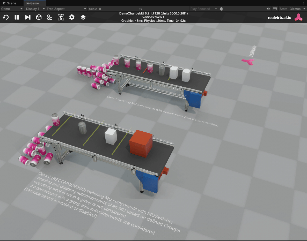

The **MU Switcher** component allows dynamic switching of parts or variants of [Moving Units (MUs) ](/components-and-scripts/mu-movable-unit.md)based on sensor triggers. It is typically used in scenarios where different configurations or visual representations of an MU need to be activated during runtime (e.g., for visual changes, turning easy MUs into complex ones and so on).
<figure><img src="https://260262196-files.gitbook.io/~/files/v0/b/gitbook-x-prod.appspot.com/o/spaces%2FpYxFg97YnJX96UzNNTSd%2Fuploads%2Fgit-blob-eca17dd4b931890e134f12e12092ac81c7da8d13%2Fmuswitcher.gif?alt=media" alt=""><figcaption><p>Changing MUs with MUSwitcher (Demo2 in DemoChangeMU demonstration model)</p></figcaption></figure>
