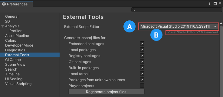

Before scripting in C# you need to install Visual Studio or Rider. Please check the documentation on the Unity website about installing Visual Studio:
{% embed url="<https://docs.unity3d.com/Manual/VisualStudioIntegration.html>" %}
Please make sure, that your scripting environment is linked as external tool like shown below:
<figure><img src="https://260262196-files.gitbook.io/~/files/v0/b/gitbook-x-prod.appspot.com/o/spaces%2FpYxFg97YnJX96UzNNTSd%2Fuploads%2Fgit-blob-588a1c694d9833079cd01a2f802b7876a9b69dc5%2FVS-external-tools.png?alt=media" alt=""><figcaption></figcaption></figure>
