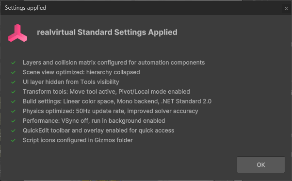

## Settings Applied
Applying standard settings will configure:
* **Standard layer naming** (for physics)
* **Standard physics collision matrix**
* **Standard light settings**
<figure><img src="https://260262196-files.gitbook.io/~/files/v0/b/gitbook-x-prod.appspot.com/o/spaces%2FpYxFg97YnJX96UzNNTSd%2Fuploads%2Fgit-blob-b5063aa1c1efc7323beee2c32e6eb462ece34cd2%2Frecommended-project-settings-applied.png?alt=media" alt="Applied Settings Summary"><figcaption><p>Summary of successfully applied settings showing layers, scene view, build settings, physics, and performance optimizations</p></figcaption></figure>
### Additional Optimizations
The system also configures additional Unity settings for optimal industrial automation performance:
#### Project Structure
* **Layers & Collision Matrix**: Configured for automation components
* **Scene View Optimization**: Hierarchy collapsed, shaded mode enabled
* **UI Layer Management**: Hidden from Tools visibility for cleaner interface
#### Development Tools
* **Transform Tools**: Move tool active with Pivot/Local mode enabled
* **realvirtual Tools**: QuickEdit toolbar and overlay enabled
* **Script Icons**: Configured in Gizmos folder for better visual identification
#### Build & Runtime Settings
* **Build Settings**: Linear color space, Mono backend, .NET Standard 2.0
* **Physics Optimization**: 50Hz update rate with improved solver accuracy
* **Performance Settings**: VSync disabled, background execution enabled

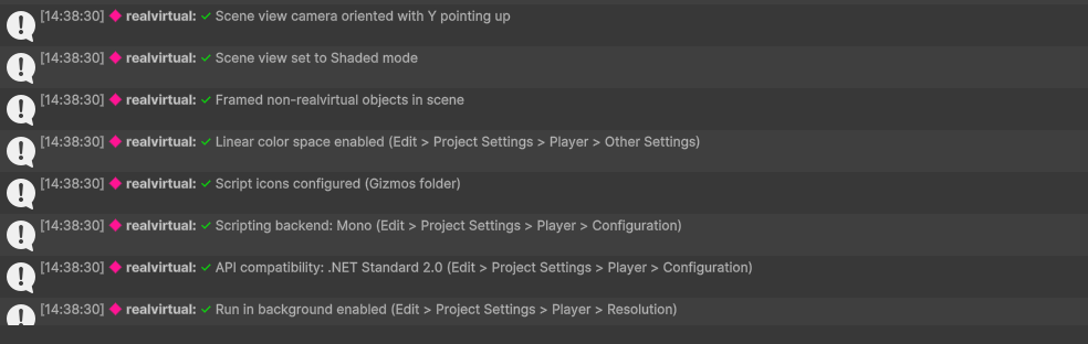

## Detailed Logging
The Console provides detailed information about each change made during the configuration process:
<figure><img src="https://260262196-files.gitbook.io/~/files/v0/b/gitbook-x-prod.appspot.com/o/spaces%2FpYxFg97YnJX96UzNNTSd%2Fuploads%2Fgit-blob-c994bd48ff6aa6b43c30a584171d40b3257b9aa9%2Frecommended-project-settings-console.png?alt=media" alt="Console Log Details"><figcaption><p>Console log showing detailed information about each setting applied, including specific Unity menu paths</p></figcaption></figure>
The console log shows:
* Timestamped entries for each change
* Specific Unity menu paths for verification
* Confirmation of successful application
* Reference information for troubleshooting
