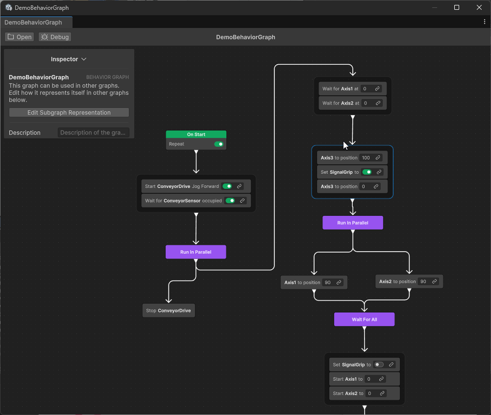

You can find a Demo scene here: Assets/realvirtual/BehaviorGraph/DemoBehaviorGraph.unity
<figure><img src="https://260262196-files.gitbook.io/~/files/v0/b/gitbook-x-prod.appspot.com/o/spaces%2FpYxFg97YnJX96UzNNTSd%2Fuploads%2Fgit-blob-0b0ba6c0b266086ddf3f7a522da35f0406243af0%2Fbehavior-graph.png?alt=media" alt=""><figcaption><p>Behavior Graph in the Behavior Demo Scene</p></figcaption></figure>

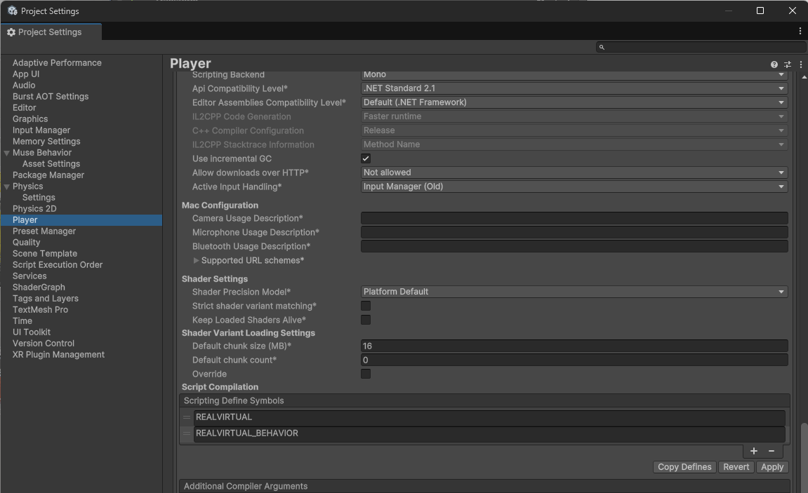

* **Set Up Scripting Define Symbols**:
  * Navigate to **Edit > Project Settings > Player**.
  * Under the **Other Settings** section, locate **Scripting Define Symbols**.
  * Add `REALVIRTUAL_BEHAVIOR` to the list of symbols.
  * Save and close the settings.
<figure><img src="https://260262196-files.gitbook.io/~/files/v0/b/gitbook-x-prod.appspot.com/o/spaces%2FpYxFg97YnJX96UzNNTSd%2Fuploads%2Fgit-blob-9925eb76d400d87273159f3c85f080f02670ea45%2Fbehavior-playersettings.png?alt=media" alt=""><figcaption></figcaption></figure>

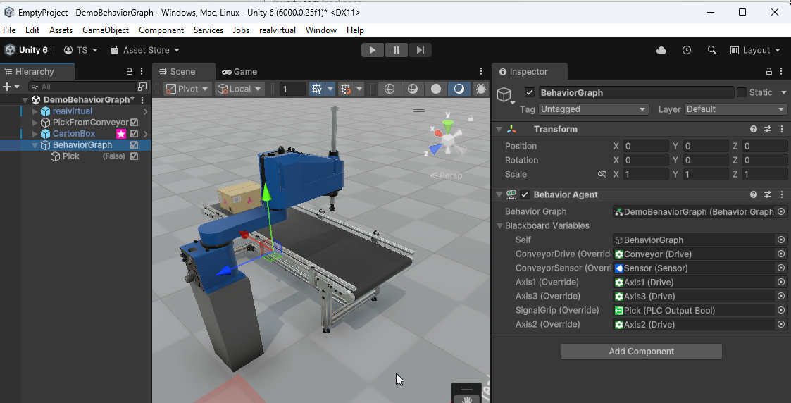

**Assigning the Behavior Graph**:
* Add a **Behavior Agent** component to a GameObject in your scene.
* Assign the newly created graph file to the component.
#### Using Behavior Graphs Across Scenes
* **Behavior Graphs are reusable**: You can use the same behavior graph across multiple scenes by attaching it to different objects.
* **Scene-specific connections**: To connect the graph variables to scene objects, you must link them in the **Behavior Agent** (see below).
<figure><img src="https://260262196-files.gitbook.io/~/files/v0/b/gitbook-x-prod.appspot.com/o/spaces%2FpYxFg97YnJX96UzNNTSd%2Fuploads%2Fgit-blob-1e4af304312cf0190a4a1795300110b1c06c00c7%2Fbehavior-agent.png?alt=media" alt=""><figcaption></figcaption></figure>
