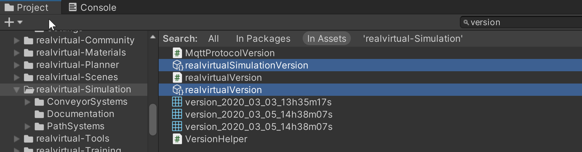

* **Version Information**: Always provide the version of realvirtual.io Professional/Starter and realvirtual.io Simulation you are using (search for "version" in your project folder to find the version numbers and check the properties in the inspector).
<figure><img src="https://260262196-files.gitbook.io/~/files/v0/b/gitbook-x-prod.appspot.com/o/spaces%2FpYxFg97YnJX96UzNNTSd%2Fuploads%2Fgit-blob-9fe58bc6ab338eb37ebb287c234ee29c1d920f5a%2Fimage.png?alt=media" alt=""><figcaption><p>Getting the version numbers.</p></figcaption></figure>
