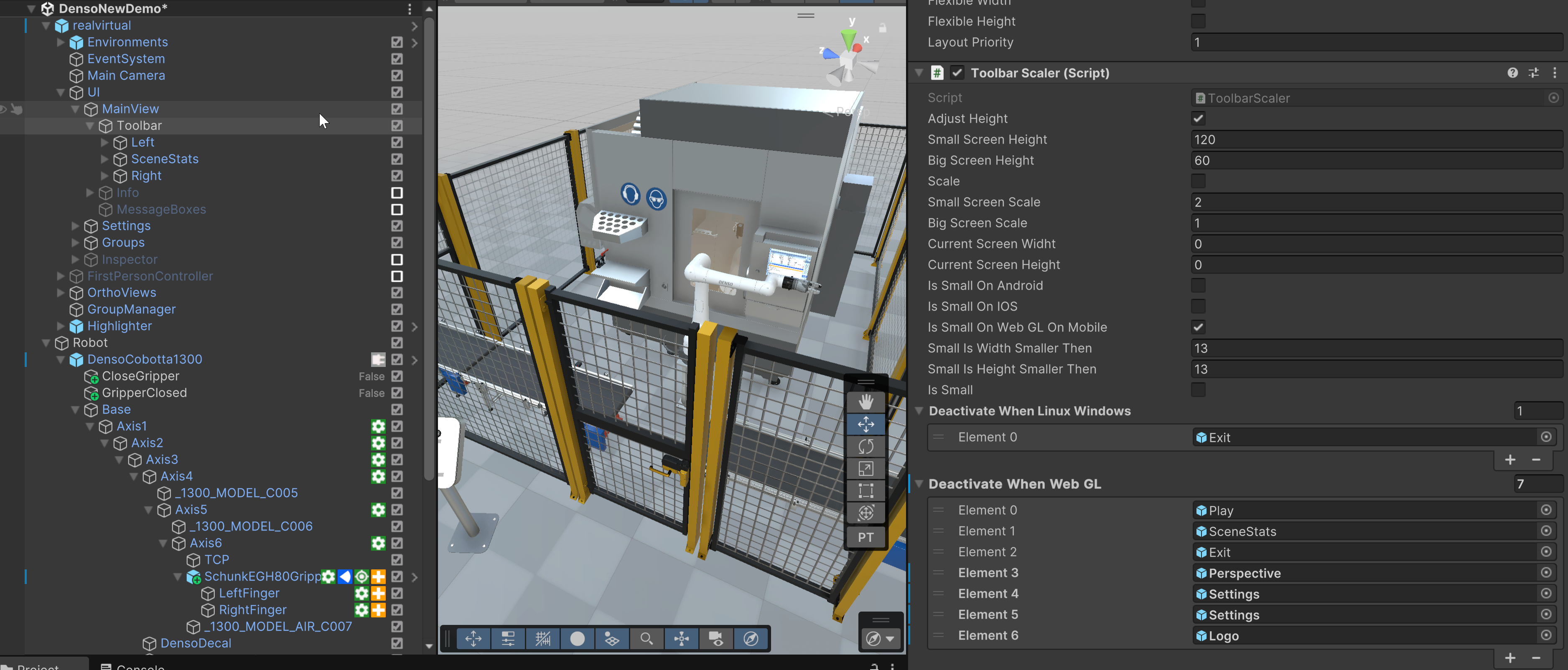

#### **Toolbar Scaler**
The **Toolbar Scaler** ensures that toolbars scale properly depending on screen size and platform.
* **Adjusts toolbar height and scale** dynamically.
* **Handles scaling for different screen resolutions**, ensuring UI elements remain accessible.
* **Platform-specific deactivation:**
  * Allows disabling elements for **Linux, Windows, and WebGL** when needed.

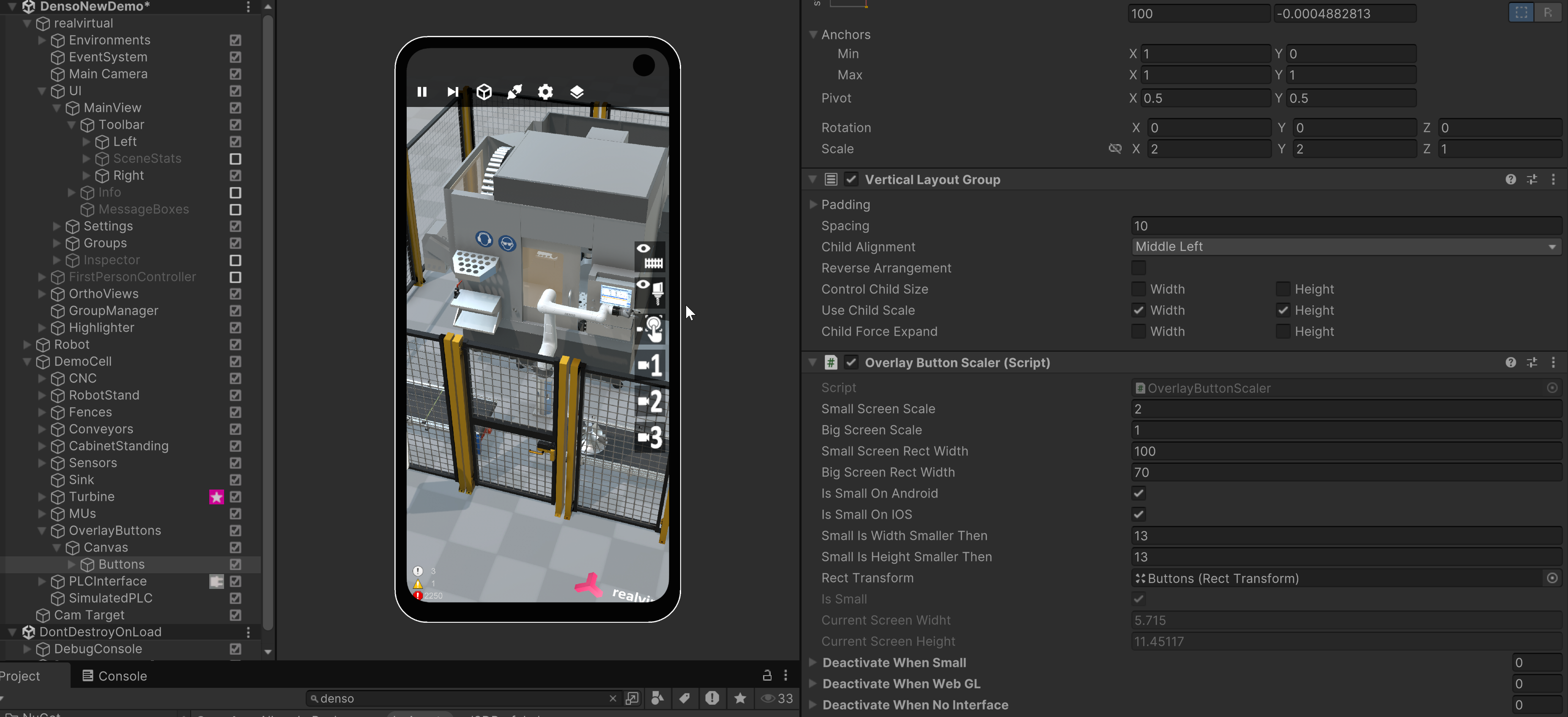

#### **Overlay Button Scaler**
The **Overlay Button Scaler** is used for the ovlerlay buttons on the right hand side.
* **Dynamically scales UI buttons based on screen size.**
* **Custom width and height settings** for different screen resolutions.
* **Supports platform-based UI adjustments** (e.g., different behaviors for **Android, iOS, WebGL**).
