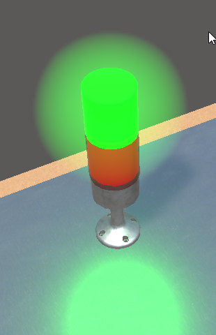

The **Lamp** component turns any mesh into a visual status indicator — a signal tower light, a button lamp, a machine state beacon. It drives the emission color and intensity of the renderer through a `MaterialPropertyBlock`, so no per-renderer material is instantiated and GPU batching is preserved. The lamp can be switched on and off, set to flash at a configurable rate, and driven directly from PLC signals.
<div align="left"><figure><img src="https://260262196-files.gitbook.io/~/files/v0/b/gitbook-x-prod.appspot.com/o/spaces%2FpYxFg97YnJX96UzNNTSd%2Fuploads%2Fgit-blob-7bc31fcd120c8f5182f925314df56121860b70d7%2Flamp.png?alt=media" alt="Lamp status indicator"><figcaption></figcaption></figure></div>
This component was reworked in realvirtual **6.3.3** to use emission overrides via `MaterialPropertyBlock`.
{% hint style="warning" %}
The shared material on the lamp's MeshRenderer must have **emission enabled** (URP Lit, HDRP Lit, or Standard with the `_EMISSION` keyword active) for the color override to be visible. When you add the component in the editor it assigns the built-in **Lamp** material automatically.
