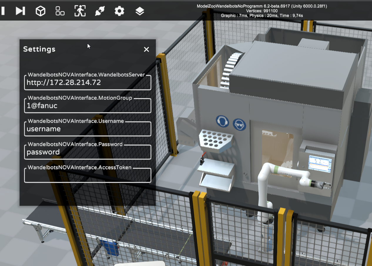

To connect the simulation with a [**Wandelbots NOVA** ](https://www.wandelbots.com/de)instance, the following parameters must be set. Open the **⚙️ Settings** window in the top menu bar to access these fields:
| Field                                      | Description                                                                       |
| `WandelbotsNOVAInterface.WandelbotsServer` | IP address or URL of your Wandelbots NOVA server (e.g. `http://172.28.214.72`)    |
| `WandelbotsNOVAInterface.MotionGroup`      | The motion group identifier for the robot (e.g. `1@fanuc` for a Fanuc CRX-10iA/L) |
| `WandelbotsNOVAInterface.Username`         | Username for NOVA login                                                           |
| `WandelbotsNOVAInterface.Password`         | Password for NOVA login                                                           |
| `WandelbotsNOVAInterface.AccessToken`      | *Optional:* Only required when connecting to a **cloud-hosted** NOVA instance     |
After entering your connection data, activate the interface using the **🔌 connect switch** in the menu bar. Once the connection is active, the plug icon will turn green.
> 💡 Note: The **Access Token** is not needed for local or offline installations—only for authenticated access to the cloud-based NOVA server.
<figure><img src="https://260262196-files.gitbook.io/~/files/v0/b/gitbook-x-prod.appspot.com/o/spaces%2FpYxFg97YnJX96UzNNTSd%2Fuploads%2Fgit-blob-8386d735f16aee142baccc584180f072e483468d%2Fimage.png?alt=media" alt=""><figcaption><p>Wandelbots NOVA interface configuration</p></figcaption></figure>
