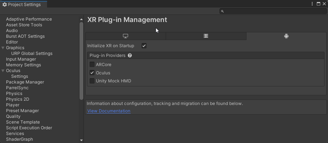

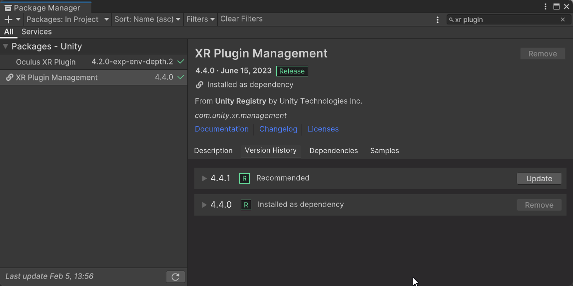

1. **Project Settings**: In Unity, go to `Edit > Project Settings > XR Plugin Management`.
2. **Install XR Plugin**: Install the XR Plugin Management.
3. **Enable Oculus Plugin**: Enable the Oculus plugin for both PC and Android platforms under the plugin providers section.

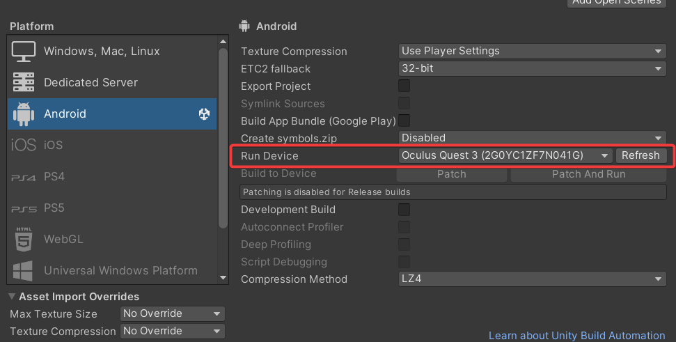

2. **Connect Quest**:
   * Connect your Quest to your PC using a USB cable.
   * Verify that the Quest is in developer mode. You will see a message in the Quest asking if you trust the connected PC
   * In Unity, set your Quest as the Run Device.
   <figure><img src="https://260262196-files.gitbook.io/~/files/v0/b/gitbook-x-prod.appspot.com/o/spaces%2FpYxFg97YnJX96UzNNTSd%2Fuploads%2Fgit-blob-7841e0d9b92a4085426889defba5fe94c0f8bec5%2Fimage.png?alt=media" alt=""><figcaption><p>Quest set as Run Device in Build Settings</p></figcaption></figure>
3. **Build and Run**:
   * Click "Build and Run" to compile your application and deploy it directly to the Quest.

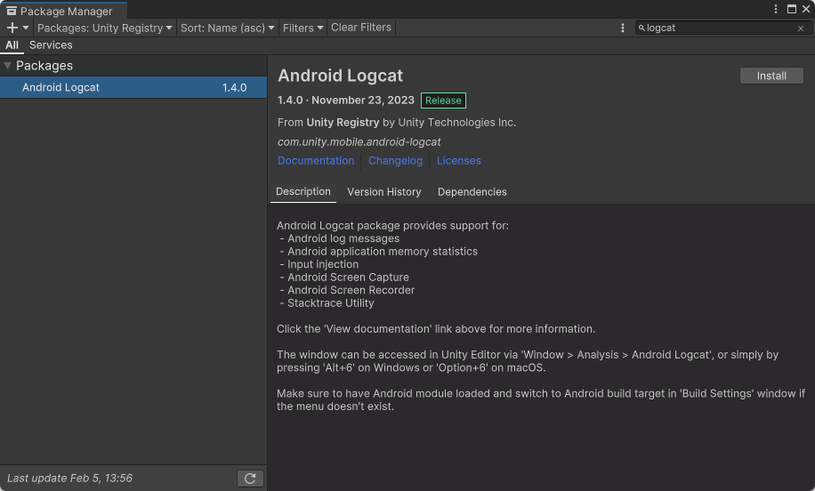

For debugging Android Applications in general and Meta Quest Applications we recommend using Android Logcat. Android Logcat is displaying live the Android log in the Unity Editor, while the Quest is connected. You can filter here for all Unity Console Log messages in a Android Application which is running on the Quest.
{% embed url="<https://docs.unity3d.com/Packages/com.unity.mobile.android-logcat@1.3/manual/index.html>" %}
Install Android Logcat via the Unity Package Manager:
<figure><img src="https://260262196-files.gitbook.io/~/files/v0/b/gitbook-x-prod.appspot.com/o/spaces%2FpYxFg97YnJX96UzNNTSd%2Fuploads%2Fgit-blob-e737f25074b1f1eb39af36e5c801ace174124966%2Fimage.png?alt=media" alt=""><figcaption><p>Installing Logcat via the Unity Package Manager</p></figcaption></figure>
To open the Android Logcat window in the Unity Editor:
* Menu: **Window** > **Analysis** > **Android Logcat**.
