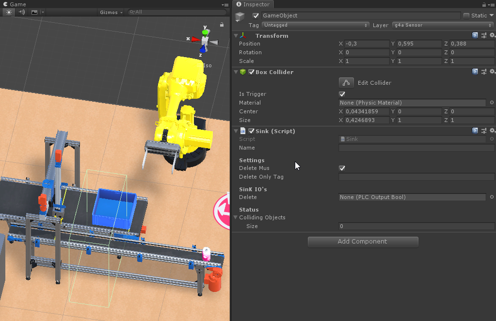

A Sink is responsible for deleting [MUs](/components-and-scripts/mu-movable-unit.md). Using a Box Collider, the Sink deletes all colliding ([MUs](/components-and-scripts/mu-movable-unit.md)):
<figure><img src="https://260262196-files.gitbook.io/~/files/v0/b/gitbook-x-prod.appspot.com/o/spaces%2FpYxFg97YnJX96UzNNTSd%2Fuploads%2Fgit-blob-fc8882c505f6fc939110339cb5b0ac365d05b356%2Fsink.png?alt=media" alt=""><figcaption></figcaption></figure>
If needed, the Sink can be controlled by a Signal *Delete*. This will activate and deactivate the Sink. The same can be done with the setting *Delete Mus*. If you define a Tag under *Delete Only Tag* only [MUs](/components-and-scripts/mu-movable-unit.md) with the specific Tag will be deleted.
> Please take care that the Sink is situated on the correct layer, to enable collision detection. Usually the sink should be placed on the rvSensor Layer (before 2022 g4aSensor Layer).
