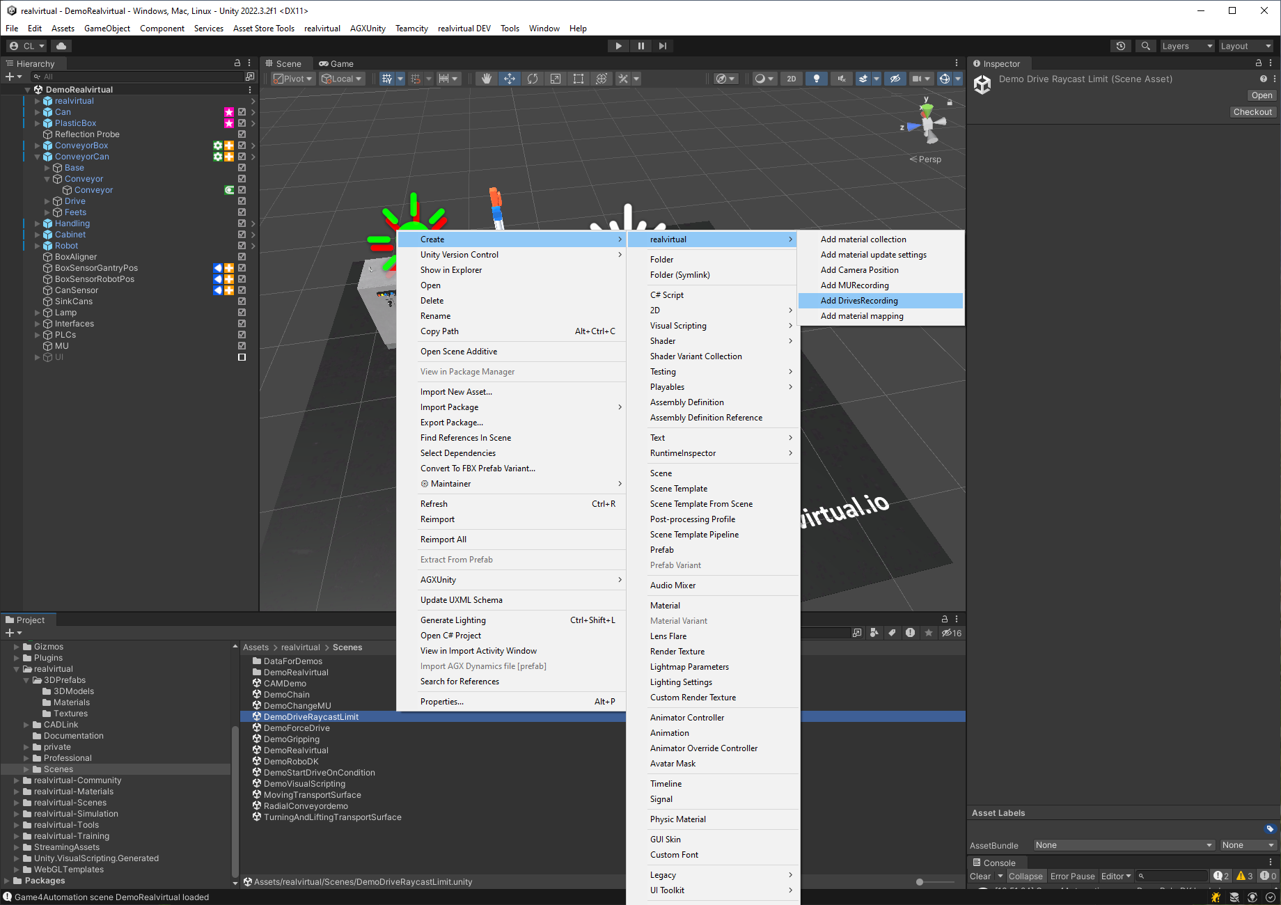

In addition to the DrivesRecorder component, you need to create a ScriptableObject DrivesRecording. Right mouse click in the folder where your scene is located. The image below illustrates how to create the DrivesRecording object.

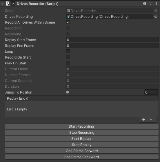

The DrivesRecorder provides the following attributes:
<div align="left"><figure><img src="https://260262196-files.gitbook.io/~/files/v0/b/gitbook-x-prod.appspot.com/o/spaces%2FpYxFg97YnJX96UzNNTSd%2Fuploads%2Fgit-blob-f3e046f79ada34172c50b107cf3e286a23ec7da2%2FdrivesRecorder.png?alt=media" alt=""><figcaption><p>Attributes DrivesRecorder</p></figcaption></figure></div>
<table><thead><tr><th width="317">Attribute</th><th>Function</th><th data-hidden></th></tr></thead><tbody><tr><td>Drives Recording</td><td>Recording object which stores the record</td><td></td></tr><tr><td>Record all drives within the scene</td><td>boolean wether all drives in the scene should be recorded</td><td></td></tr><tr><td>Recording / Replaying</td><td>Information which mode is currently active</td><td></td></tr><tr><td>Replay Start Frame</td><td>Frame at which the replay starts</td><td></td></tr><tr><td>Replay End Frame</td><td>Frame at which the replay ends</td><td></td></tr><tr><td>Loop</td><td>loops the current replay</td><td></td></tr><tr><td>Record On Start</td><td>boolean: true -> record starts with the start of the game mode</td><td></td></tr><tr><td>Play On Start</td><td>boolean: true -> replay starts with the start of the game mode</td><td></td></tr><tr><td>Current Frame/ Number Frames/ Current Seconds/ Duration</td><td>Information about the current the current recording or replay</td><td></td></tr><tr><td>Jump To Position</td><td>jump to a certain frame</td><td></td></tr><tr><td>Replay End</td><td>subscribe an event which is called when the replay ends</td><td></td></tr><tr><td>Buttons</td><td>the buttons are used during runtime to start and stop the recording or the replay</td><td></td></tr></tbody></table>

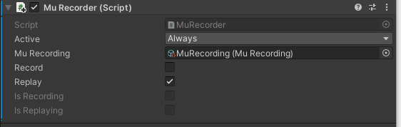

The MUrecorder provides the following attributes:
<div align="left"><figure><img src="https://260262196-files.gitbook.io/~/files/v0/b/gitbook-x-prod.appspot.com/o/spaces%2FpYxFg97YnJX96UzNNTSd%2Fuploads%2Fgit-blob-14239f96bfd5f219935d2b9a33b2d9face9bb0ba%2FMUrecorder.png?alt=media" alt=""><figcaption></figcaption></figure></div>
<table><thead><tr><th width="260">Attribute</th><th>Function</th><th data-hidden></th></tr></thead><tbody><tr><td>MUrecording</td><td>Recording object which stores the record</td><td></td></tr><tr><td>Record</td><td>boolean: true -> Recording is active</td><td></td></tr><tr><td>Replay</td><td>boolean: true -> Replay is active</td><td></td></tr><tr><td>Is Recording/ Is Replaying</td><td>Information which mode is currently active</td><td></td></tr></tbody></table>
