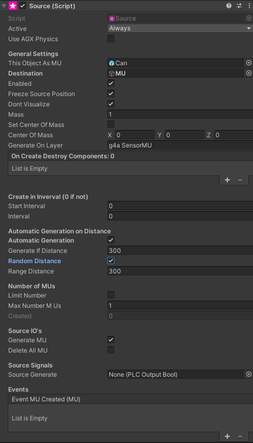

This is the property window of the source:
<div align="left"><figure><img src="https://260262196-files.gitbook.io/~/files/v0/b/gitbook-x-prod.appspot.com/o/spaces%2FpYxFg97YnJX96UzNNTSd%2Fuploads%2Fgit-blob-0c4d9452e566b211e3c4ba092723a4f06fcfc3ae%2Fsource-inspector.png?alt=media" alt=""><figcaption></figcaption></figure></div>
### Properties <a href="#properties" id="properties"></a>
#### This Object as MU
Defines which part should be generated. Should normally point to the same GameObject where the source component itself is attached to. This is also the standard setting.
**Note:** Collider enabled/disabled states are preserved from this template when generating MUs. To disable specific colliders on generated MUs, simply disable them in the template prefab before starting the simulation.
#### Destination
When the source is generating a new MU it can be placed as a sub Gameobject under the defined Destination Gameobject.
#### Enabled
Must be set to true for the source to work.
#### Freeze Source Position
Should be usually set to true - the source will not change its position.
#### Don’t Visualize
Hides the source so that only the created MUs are visible.
#### Mass
Sets the Mass of the created MUs.
#### Set Center of Mass
Sets the Center of Mass of the created MUs.
#### Center of Mass
The Center of Mass.
#### Generate on Layer
Unity Layer where the MU should be placed to after creation.
#### On Create Destroy Components
Maybe some scripts on the MU, which is a copy of the source, should be destroyed when the MU is created. You can define here the components to be destroyed.
#### Create in Interval
Creates MUs in a constant interval in seconds. If the value is 0 this option is not used.
#### Automatic Generate On Distance
Automatically creates new MUs when the distance of the last created MU is greater than the defined value. Optionally the distance can be also randomly (equally distributed) between the defined Distance (“Generate if Distance”) plus / minus the “Range Distance”.
#### Number of MUs
Limits the number of generated MUs.
#### SourceIOs
Gernarate MU - should be turned on for making the source work.
#### Source Signals
PLCOutputBool Signal (e.g. from a PLC) for generating MUs.
#### Events
Unity Event which can be used for custom scripts which are called when an MU is created.
