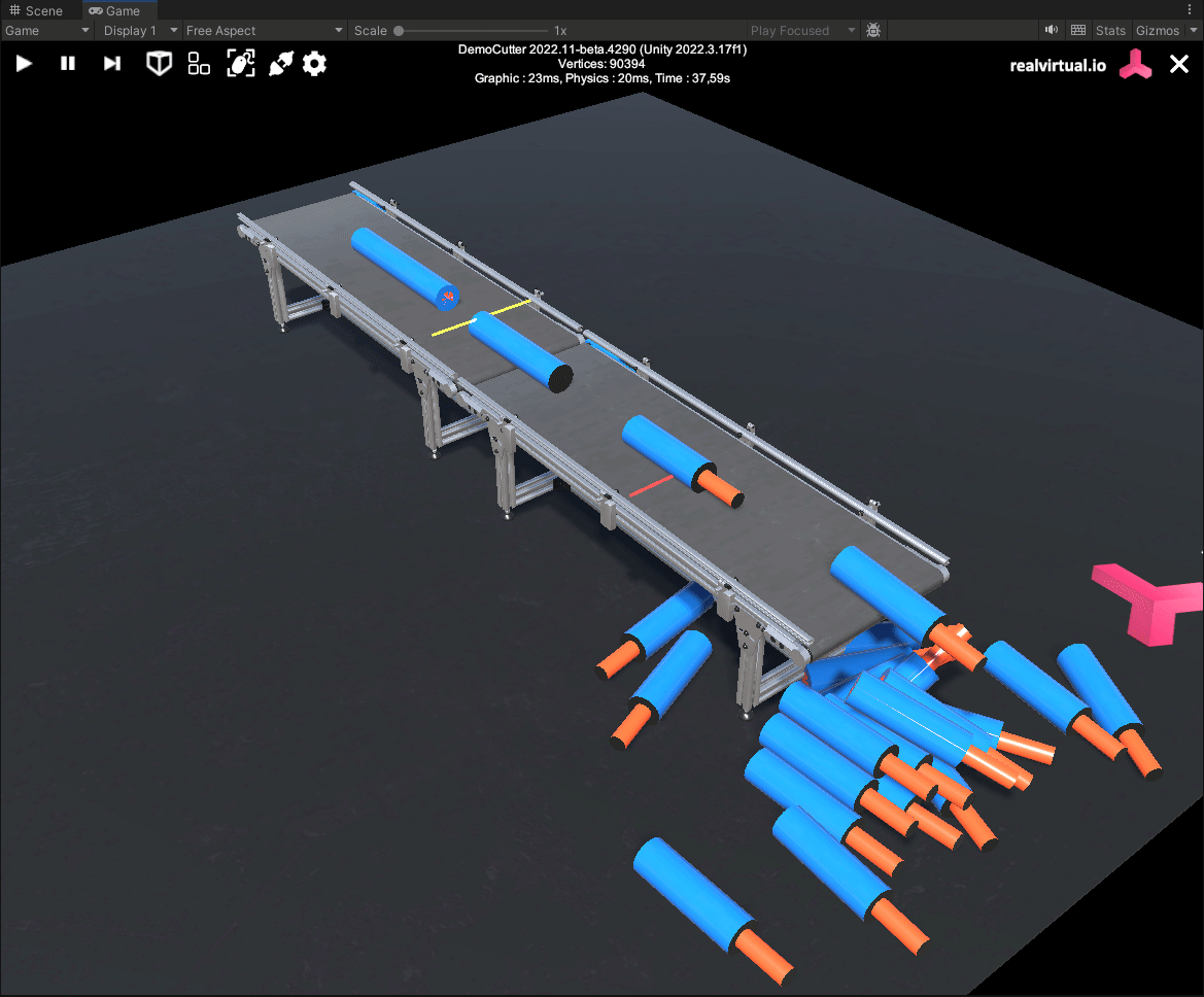

This example demonstrates two distinct cutting processes using the Cutter component, where in both instances, the positive part of each cut is deleted—a configurable option. During the first cut, the entire Movable Unit (MU) is subjected to the slicing action. In the second cut, the process is refined to only target and slice the outer mesh of the MU. The DemoCutter Scene, showcasing the Cutter component's functionality, is located in the demo folder.
<figure><img src="https://260262196-files.gitbook.io/~/files/v0/b/gitbook-x-prod.appspot.com/o/spaces%2FpYxFg97YnJX96UzNNTSd%2Fuploads%2Fgit-blob-b818bbd43fca166c58b7b41c282e8d1f0e2cfb0f%2FUnity_dP4queD00l.gif?alt=media" alt=""><figcaption><p>Cutting MUs with the Cutter component</p></figcaption></figure>

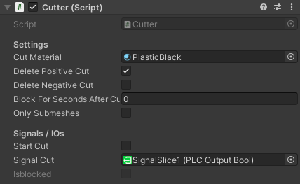

<figure><img src="https://260262196-files.gitbook.io/~/files/v0/b/gitbook-x-prod.appspot.com/o/spaces%2FpYxFg97YnJX96UzNNTSd%2Fuploads%2Fgit-blob-3223ab2ab42e8abd49a5b43e2059823c100ec534%2Fimage.png?alt=media" alt=""><figcaption><p>Cutter component</p></figcaption></figure>
The simplest method to utilize the Cutter component is by dragging and dropping the Cutter prefab directly into your scene. All cutting actions performed by this component are based on the Plane, which is oriented according to the Y direction of the component.
**Settings**
* **Cut Material**: Assigns a material to the faces created by the cut.
* **Delete Options**: Allows for the deletion of either the positive or negative side of the cut object.
* **Block For Seconds After Cut**: Temporarily disables cutting after a cut is performed to prevent rapid successive cuts.
* **Submesh Cutting**: Option to cut only specified submeshes by tagging them.
**Signals / IOs**
* **Start Cut**: A boolean signal that, when true, initiates the cutting process. This can be linked to an external PLC signal for automation.
* **Signal Cut**: Represents an external trigger for starting the cutting process.
