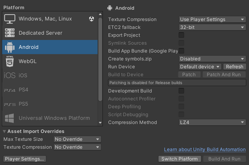

### 5. Add Android Build Support
**Unity Hub**: Use UnityHub to add Android build support to your specific Unity version.
### 6. Switch to Android Platform
Make sure your project is configuredto build for android. Navigate to File > Build Settings and switch to the android platform.
<figure><img src="https://260262196-files.gitbook.io/~/files/v0/b/gitbook-x-prod.appspot.com/o/spaces%2FpYxFg97YnJX96UzNNTSd%2Fuploads%2Fgit-blob-b984c5efe41b76432fa18cfdc2e7402a62521cc6%2FScreenshot%202024-03-08%20121200.png?alt=media" alt="" width="375"><figcaption></figcaption></figure>
