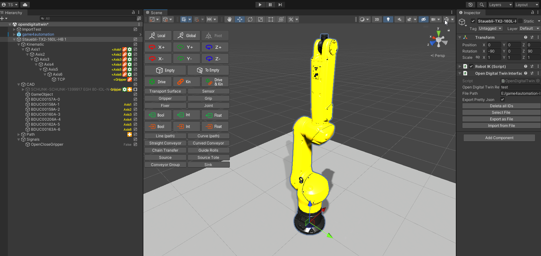

This is our example model from which the JSON data (see below) was generated:
This robot can be generated and exported with the Open Digital Twin Interface

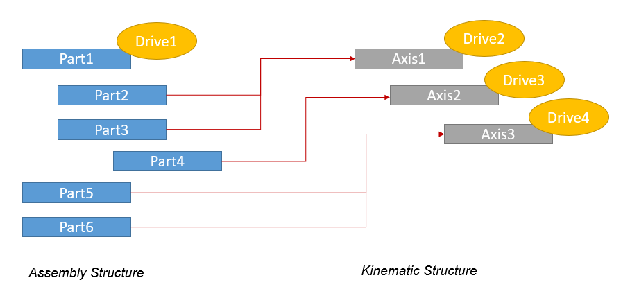

Separated assembly and kinematic structure
CAD designs are mostly not kinematic structured. Therefore, the KinematicAssembly optionally builds a parallel kinematic structure. Each part in the design structure can be assigned to an element Kinematic in the KinematicAssembly. Drives and Sensors can be attached to the Assembly as well as to the Kinematic Structure.
