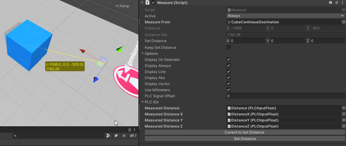

Measure is measuring distances between the pivot point of the Gameobject, the Measure script is attached to and another pivot point of a referenced Gameobject.
You can also connect the result of the measurement to a PLCInput Signal. By doing this Measure is able to act as a distance sensor.
<figure><img src="https://260262196-files.gitbook.io/~/files/v0/b/gitbook-x-prod.appspot.com/o/spaces%2FpYxFg97YnJX96UzNNTSd%2Fuploads%2Fgit-blob-da68351b4ea63814aaf9b7cfaf0980a1e8ef613a%2Fmeasure.png?alt=media" alt=""><figcaption></figcaption></figure>
You can apply the following properties:
| Property            | Description                                                                                                                                      |
| Measure From        | Gameobject the measurement should be performed from to this object.                                                                              |
| Distance            | (Readonly) The measured distance as a vector.                                                                                                    |
| Distance Abs        | (Readonly) The measured distance as an absolute value.                                                                                           |
| Set Distance        | A distance that should be set by the button Set Distance                                                                                         |
| Keep Set Distance   | If set to true the SetDistance value is always set to the related Gameobject so that the distance between the two objects always keeps the same. |
| Display On Selected | Display the measurement only when the measurement object is selected.                                                                            |
| Display Always      | Display the measurement always.                                                                                                                  |
| Display Line        | Display a line between the Pivot Points in scene view.                                                                                           |
| Display Abs         | Display the absolute value as a number in scene view.                                                                                            |
| Display Vector      | Display the vector as numbers in scene view.                                                                                                     |
| Use Millimeters     | Display one Unity Unit as 1000.                                                                                                                  |
| PLCSignalOffset     | Offeset to the MeasuredDistance.                                                                                                                 |
| Measured Distance   | PLCInputFloat signal for the absolute distance.                                                                                                  |
| Measured DistanceX  | PLCInputFloat signal for the DistanceX part of the Vector.                                                                                       |
| Measured DistanceY  | PLCInputFloat signal for the DistanceY part of the Vector.                                                                                       |
| Measured DistanceZ  | PLCInputFloat signal for the DistanceZ part of the Vector.                                                                                       |
