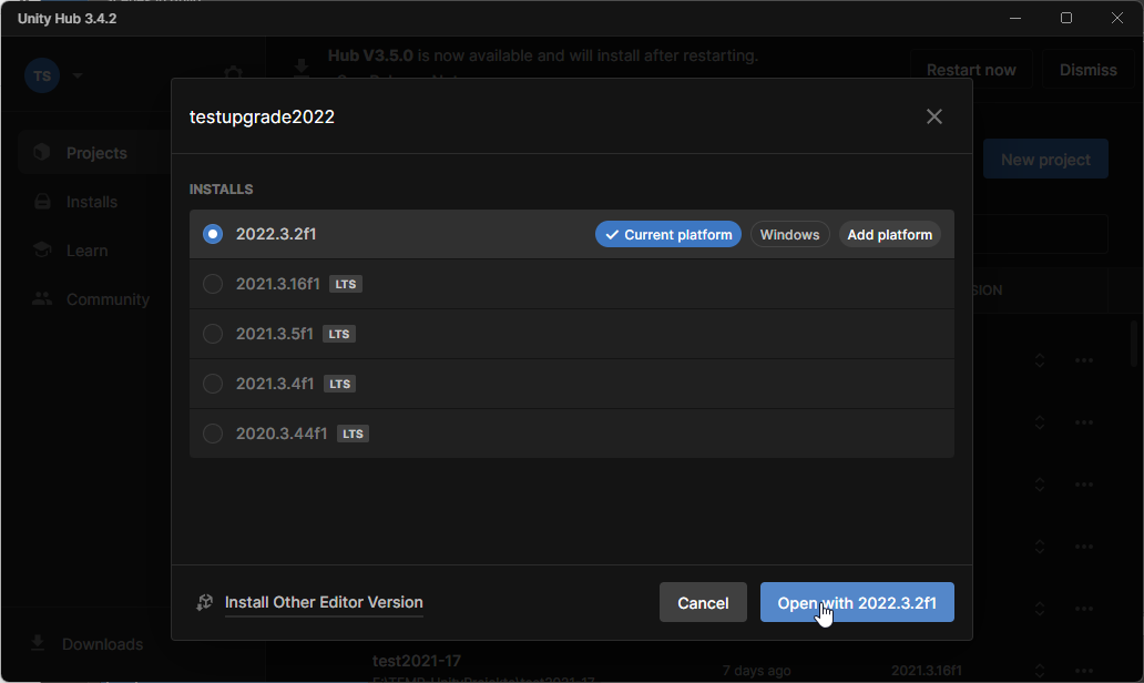

## Upgrade your existing Project to Unity 2022
Begin by upgrading your project to Unity 2022. Install the latest Unity 2022.3 release and open your existing project using the installed 2022.3 editor version. You will be prompted to confirm the editor version change. Your project should now open in Unity 2022, and you may encounter an error which can be ignored.
<figure><img src="https://260262196-files.gitbook.io/~/files/v0/b/gitbook-x-prod.appspot.com/o/spaces%2FpYxFg97YnJX96UzNNTSd%2Fuploads%2Fgit-blob-6652215afebc46fd11a9652f15c9c72976142d67%2Fupgrade2022-project.png?alt=media" alt=""><figcaption><p>Opening the project with 2022.3.X</p></figcaption></figure>
You will be asked to agree to changing the editor version. Your project should now open in Unity 2022. There might be an error which you can ignore.

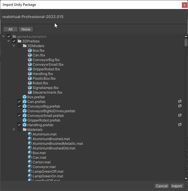

## Import realvirtual 2022
Next, import the latest realvirtual 2022 release by navigating to Assets > Import Custom Package. Select "Import" in the Import Package Window.
<figure><img src="https://260262196-files.gitbook.io/~/files/v0/b/gitbook-x-prod.appspot.com/o/spaces%2FpYxFg97YnJX96UzNNTSd%2Fuploads%2Fgit-blob-c946aec75034a0727dbf3593703a866cb9599947%2Fupgrade2022-importpackage.png?alt=media" alt=""><figcaption></figcaption></figure>
You will see several error messages in the console window, and the project structure will still contain the "game4automation" folder along with an additional "realvirtual" folder.

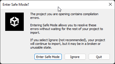

## Delete game4automation folder
Although all necessary files have been imported and the references are intact, the project still contains outdated assembly definitions and the "game4automation" folder. Close Unity, **delete the entire "game4automation" folder from the project**, and then reopen Unity. When prompted with the Enter Safe Mode message, select "Ignore."
<figure><img src="https://260262196-files.gitbook.io/~/files/v0/b/gitbook-x-prod.appspot.com/o/spaces%2FpYxFg97YnJX96UzNNTSd%2Fuploads%2Fgit-blob-5ab36377f7018c298de4cf07ee2edd0d4d6be3ce%2Fupgrade2022-ignoresafemode.png?alt=media" alt=""><figcaption></figcaption></figure>

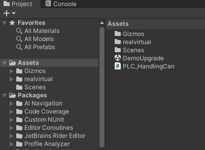

## Import realvirtual 2022 once again.
Import the realvirtual 2022 package once again.
<figure><img src="https://260262196-files.gitbook.io/~/files/v0/b/gitbook-x-prod.appspot.com/o/spaces%2FpYxFg97YnJX96UzNNTSd%2Fuploads%2Fgit-blob-678e6efd800c9b56d3ad100245b1fa43a68e45d2%2Fupgrade2022-importagain.png?alt=media" alt=""><figcaption></figcaption></figure>
After the import, your project structure should resemble the following (with the possibility of additional custom folders you are having in the project), containing only the "realvirtual" folder.
<figure><img src="https://260262196-files.gitbook.io/~/files/v0/b/gitbook-x-prod.appspot.com/o/spaces%2FpYxFg97YnJX96UzNNTSd%2Fuploads%2Fgit-blob-84ef9017fc6176012a3dddbaeeb5fa2fcac8220d%2Fupgrade2022-newfolder.png?alt=media" alt=""><figcaption></figcaption></figure>
You will now encounter several error messages related to your custom scripts. The primary reason for these errors is the namespace change from "game4automation" to "realvirtual" in the realvirtual package.

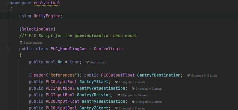

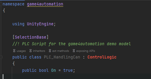

To resolve the compile errors caused by your custom scripts, you need to replace all references to the "game4automation" namespace with "realvirtual" in your scripts.
Update the namespace declaration from "namespace game4automation" to "namespace realvirtual" and modify any "using game4automation" statements to "using realvirtual."
<figure><img src="https://260262196-files.gitbook.io/~/files/v0/b/gitbook-x-prod.appspot.com/o/spaces%2FpYxFg97YnJX96UzNNTSd%2Fuploads%2Fgit-blob-286e736ff13fd7242801365c0f3ef364dce622c5%2Fupgrade2022-namespacebefore.png?alt=media" alt=""><figcaption><p>namespace before changes</p></figcaption></figure>
<figure><img src="https://260262196-files.gitbook.io/~/files/v0/b/gitbook-x-prod.appspot.com/o/spaces%2FpYxFg97YnJX96UzNNTSd%2Fuploads%2Fgit-blob-f9b23166c48653dd0b38a3dcc6ee37fc749701b6%2Fupgrade2022-namespaceafter.png?alt=media" alt=""><figcaption><p>namespace after al changing to realvirtual</p></figcaption></figure>
Upon completing these namespace changes, the console log should no longer display any compile errors caused by your custom scripts.

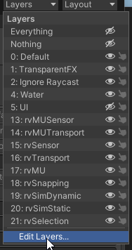

## Upgrading the layers in your custom scenes
In addition to the namespace changes, the layer naming has been updated to a new standard (refer to the [Physics](/basics/physics.md) section for details). Since your scenes might still utilize the old layer names, you need to update them to the new standard.

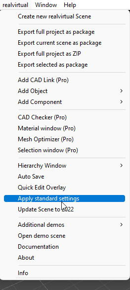

To ensure that the new layers exist in your project, select "realvirtual" followed by "Apply standard settings." This action will populate the new layers in the physics settings.
<figure><img src="https://260262196-files.gitbook.io/~/files/v0/b/gitbook-x-prod.appspot.com/o/spaces%2FpYxFg97YnJX96UzNNTSd%2Fuploads%2Fgit-blob-06a379b5812cb14770e4905d262032e81ad21338%2Fupgrade2022-applystandardsettings.png?alt=media" alt=""><figcaption></figcaption></figure>
There may still be remnants of old layers (starting with "g4a"), which you can delete by selecting "Edit Layers."
<figure><img src="https://260262196-files.gitbook.io/~/files/v0/b/gitbook-x-prod.appspot.com/o/spaces%2FpYxFg97YnJX96UzNNTSd%2Fuploads%2Fgit-blob-2d3cda2f655e59e62e2a12e057de1fe2bd033bee%2Fupgrade2022-editlayers.png?alt=media" alt=""><figcaption></figcaption></figure>

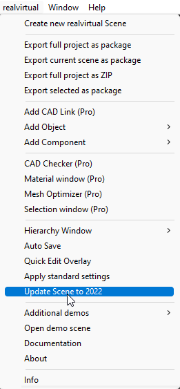

Next, open your scene. To assist you in modifying the scene settings, an upgrade helper is provided. Choose "realvirtual" and then "Update Scene to 2022."
<figure><img src="https://260262196-files.gitbook.io/~/files/v0/b/gitbook-x-prod.appspot.com/o/spaces%2FpYxFg97YnJX96UzNNTSd%2Fuploads%2Fgit-blob-f0546cb82150a7198ca7ac076ae7ead89418fd61%2Fupgrade2022-updatescene.png?alt=media" alt=""><figcaption><p>Update layers in current scene</p></figcaption></figure>
This action will update the most common layer settings in your scene. However, please double-check that all collider settings and layers in your scene align with the new layer naming convention
