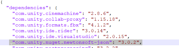

If yo don't have any dependency in your project to Newtonsoft JSON you can manually add the dependency by adding this line to *manifest.json* (can be found in the folder Packes):
<figure><img src="https://260262196-files.gitbook.io/~/files/v0/b/gitbook-x-prod.appspot.com/o/spaces%2FpYxFg97YnJX96UzNNTSd%2Fuploads%2Fgit-blob-3091c65a961ef7219dc901bd90d57174a1524add%2Fmanifest-newtonsoft.png?alt=media" alt=""><figcaption></figcaption></figure>

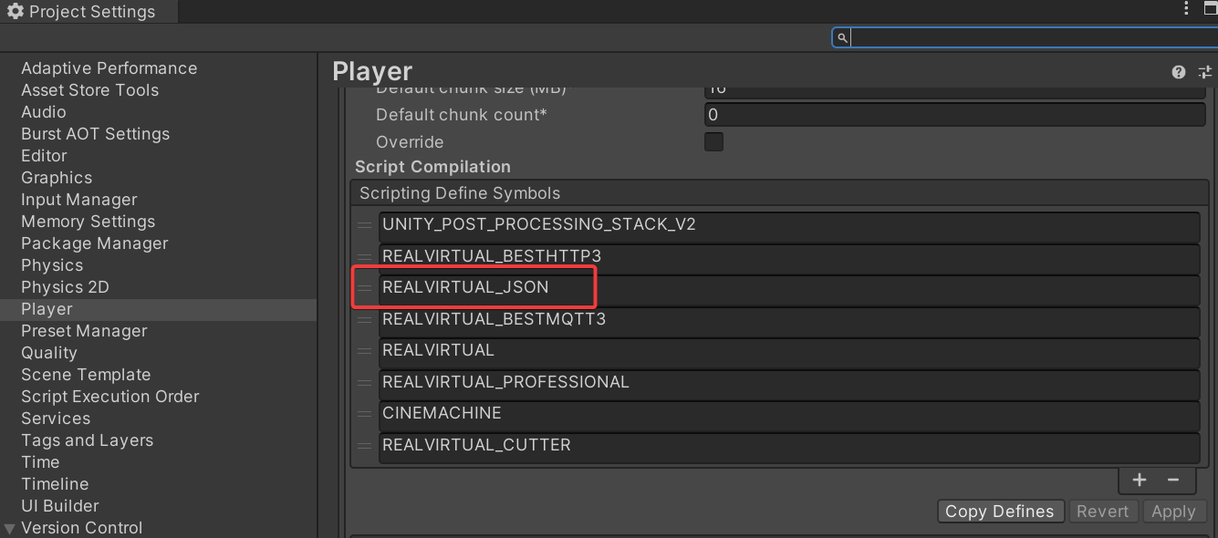

As soon as you are sure, that Newtonsoft.JSON is available in your project, *REALVIRTUAL\_JSON* needs to be set in Scripting Define Symbols:
<figure><img src="https://260262196-files.gitbook.io/~/files/v0/b/gitbook-x-prod.appspot.com/o/spaces%2FpYxFg97YnJX96UzNNTSd%2Fuploads%2Fgit-blob-b4f20dd3b2893088342d4524e5da9f8e6b656a10%2Fnewtonsoftjson%23.png?alt=media" alt=""><figcaption><p>Newtonsoft compile switch in Scripting Define Symbols (in Project Settings > Player)</p></figcaption></figure>
