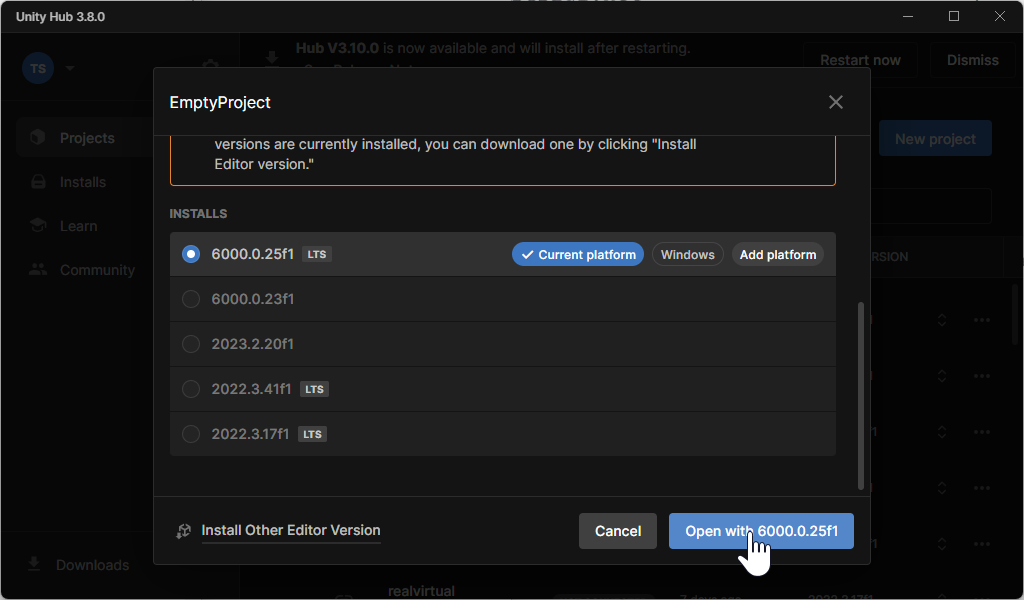

**Step 1: Prepare Your Unity Environment**
1. **Ensure Unity 6 is Installed:** Use the Unity Package Manager to install the latest Unity 6 version.
2. **Select Your Project in Unity Hub:** Open Unity Hub, select your existing project, and change the **Editor Version** to the latest version (6000.X).
3. **Confirm Version Change:** A warning will appear regarding the version change. Select **Change Version** to proceed.
<figure><img src="https://260262196-files.gitbook.io/~/files/v0/b/gitbook-x-prod.appspot.com/o/spaces%2FpYxFg97YnJX96UzNNTSd%2Fuploads%2Fgit-blob-a299833a79ab1860182fd3eb9630e9ecdc570e25%2Fupgrade-openwith6.png?alt=media" alt=""><figcaption></figcaption></figure>

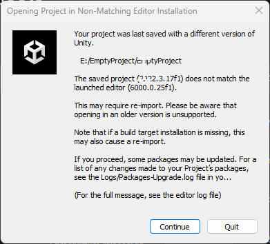

2. **Accept Compatibility Warnings:**
   * **Continue Warning:** Accept the next warning by selecting **Continue**.
   <figure><img src="https://260262196-files.gitbook.io/~/files/v0/b/gitbook-x-prod.appspot.com/o/spaces%2FpYxFg97YnJX96UzNNTSd%2Fuploads%2Fgit-blob-20c82cb0458f1e9aec2e4651c187184c3ce15ed1%2Fupgrade-saveddifferent.png?alt=media" alt=""><figcaption></figcaption></figure>
   * **Old API Warning:** You may receive a message about scripts using an older API. Confirm this and proceed. These scripts will be updated when you import realvirtual.io 6.

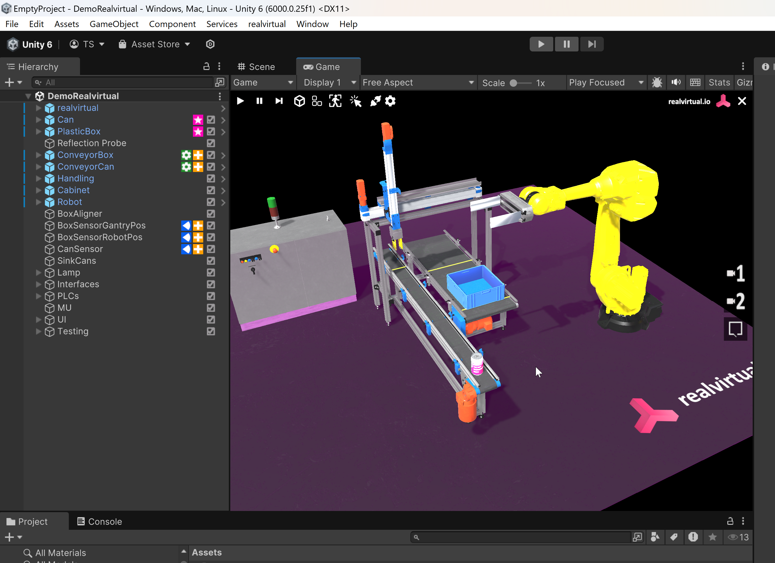

3. **Project Appearance:** Your project will open in Unity 6 and may initially appear different due to rendering pipeline changes.
<figure><img src="https://260262196-files.gitbook.io/~/files/v0/b/gitbook-x-prod.appspot.com/o/spaces%2FpYxFg97YnJX96UzNNTSd%2Fuploads%2Fgit-blob-d1276e988c8d4923f3256301dc7e2b4b1606579e%2Fupgrade-2023-in6.png?alt=media" alt="" width="563"><figcaption></figcaption></figure>

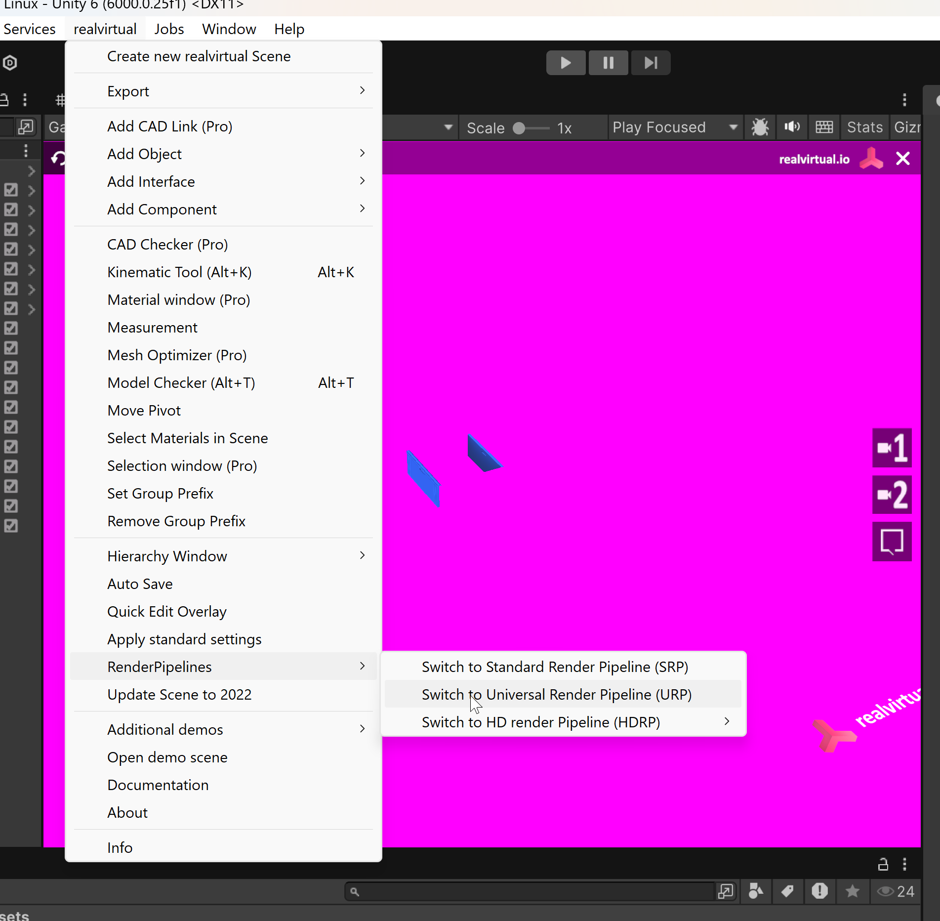

**Step 3: Update Materials to URP**
1. **Pink Materials Issue:** Materials in your scene might appear pink. This happens if your previous project used the Standard Rendering Pipeline.
2. **Convert Materials to URP:** Go to **Tools > realvirtual > RenderPipelines > Switch to Universal Render Pipeline (URP)**. This action will convert all materials in your project to be compatible with URP.
<figure><img src="https://260262196-files.gitbook.io/~/files/v0/b/gitbook-x-prod.appspot.com/o/spaces%2FpYxFg97YnJX96UzNNTSd%2Fuploads%2Fgit-blob-a1ed58a529eeee13b120ae8d25ef5fa4d0d6f208%2Fupgrade-switchtourp.png?alt=media" alt=""><figcaption></figcaption></figure>
{% hint style="warning" %}
**Important:** Update materials to URP before importing the realvirtual.io 6 package to ensure proper rendering and avoid material conflicts.
