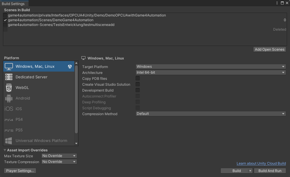

For publishing you first need to define your build settings. Build settings is opened by `File > Build Settings...`
<figure><img src="https://260262196-files.gitbook.io/~/files/v0/b/gitbook-x-prod.appspot.com/o/spaces%2FpYxFg97YnJX96UzNNTSd%2Fuploads%2Fgit-blob-352ac93c4c4281dad62a679564273f11857b8baf%2Fpublishing-buildsettings.png?alt=media" alt=""><figcaption><p>Build settings</p></figcaption></figure>
In Build settings the destination platform (WebGL, Windows, Linux, Mac, Android, iOS and so on) and the scene (the model) which should be included into build needs to be defined.
After selecting Build you are asked to define the destination folder of your build.
For some destination platforms you need to install additional packages to your Unity installation.
There are some limitations, specially with some interfaces, for some destination platforms, which are described in [Supported Platforms](/advanced-topics/supported-platforms.md)
