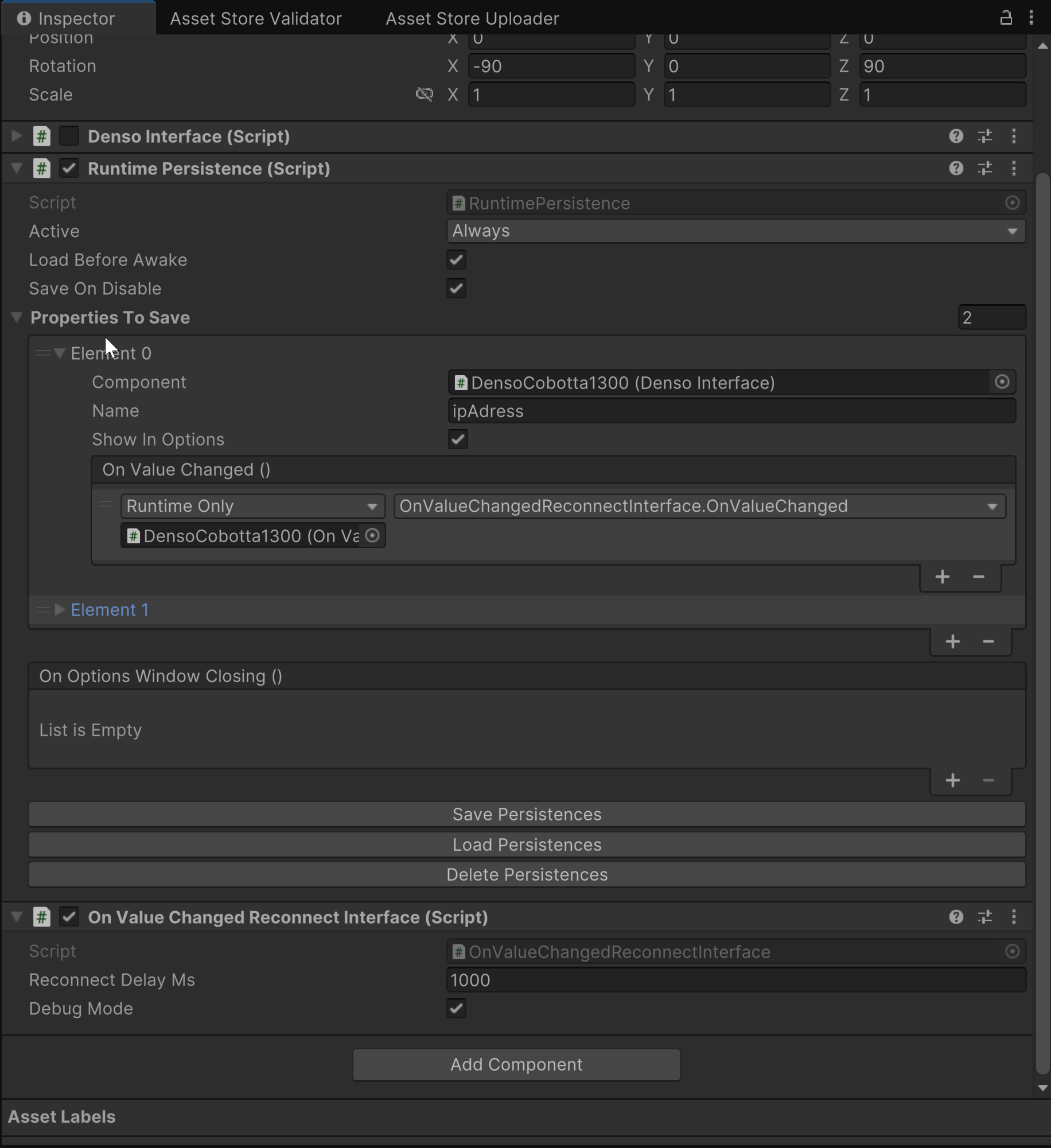

## Saving Data via Runtime Persistence Component
The **Runtime Persistence** component allows saving and restoring **component properties** in Unity **without custom programming**. It enables automatic persistence of values such as **interface settings, network configurations, and UI preferences** across sessions. Besides the persistence itself properties can be configured to be editable via the Options window during Runtime.

<figure><img src="https://260262196-files.gitbook.io/~/files/v0/b/gitbook-x-prod.appspot.com/o/spaces%2FpYxFg97YnJX96UzNNTSd%2Fuploads%2Fgit-blob-40c4665ebffc093d6956fd9546f701b16b2c4df4%2Fruntimepersistance.png?alt=media" alt=""><figcaption><p>Runtime Persistence Component</p></figcaption></figure>
### **How to Use the Runtime Persistence Component**
1. **Attach the Component**
   * Add the **Runtime Persistence** script to the GameObject containing the properties you want to save.
2. **Assign Properties to Save**
   * Under **Properties to Save**, click **+** to add a new property.
   * **Component**: Select the script containing the property.
   * **Name**: Enter the exact **property name** from the script.
3. **Enable Automatic UI Integration**
   * **Show in Options (`✔`)**: The property will be automatically added to the **realvirtual.io Options Window** for user configuration.
4. **Handling Events**
   * **OnValueChanged**: Triggered when the property is modified in the Options Window (after the user exits the field).
   * **OnOptionsWindowClosing**: Triggered when the Options Window is closed.
   * These events can be used to execute **custom logic** when values change.

### **Example Use Case (Interface Configuration)**
**Scenario:** Saving the IP address of a **Denso Interface** (`DensoCobotta1300`).
* **Component:** `DensoCobotta1300 (Denso Interface)`
* **Property Name:** `ipAdress`
* **Show in Options:** `✔` (IP field will appear in the UI).
* **OnValueChanged Event:** Calls`OnValueChangedReconnectInterface.OnValueChanged`, which **deactivates and reactivates the interface** if the IP changes.
