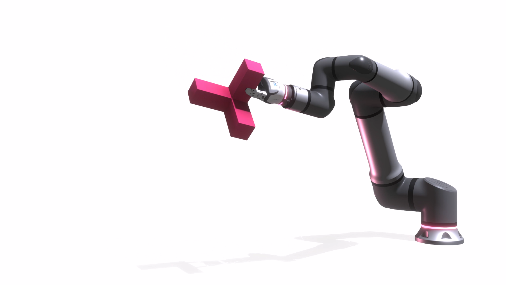

* **URP (Universal Render Pipeline)**: Strikes a balance between performance and visual quality, making it ideal for cross-platform projects and mid to high-end devices. Recommended for projects needing post-processing, high performance, and improved visual quality.
<figure><img src="https://260262196-files.gitbook.io/~/files/v0/b/gitbook-x-prod.appspot.com/o/spaces%2FpYxFg97YnJX96UzNNTSd%2Fuploads%2Fgit-blob-567a6ca9eea6a1ffdf71e04c888aede050ac527b%2Fimage.png?alt=media" alt=""><figcaption><p>UR30 robot in URP</p></figcaption></figure>

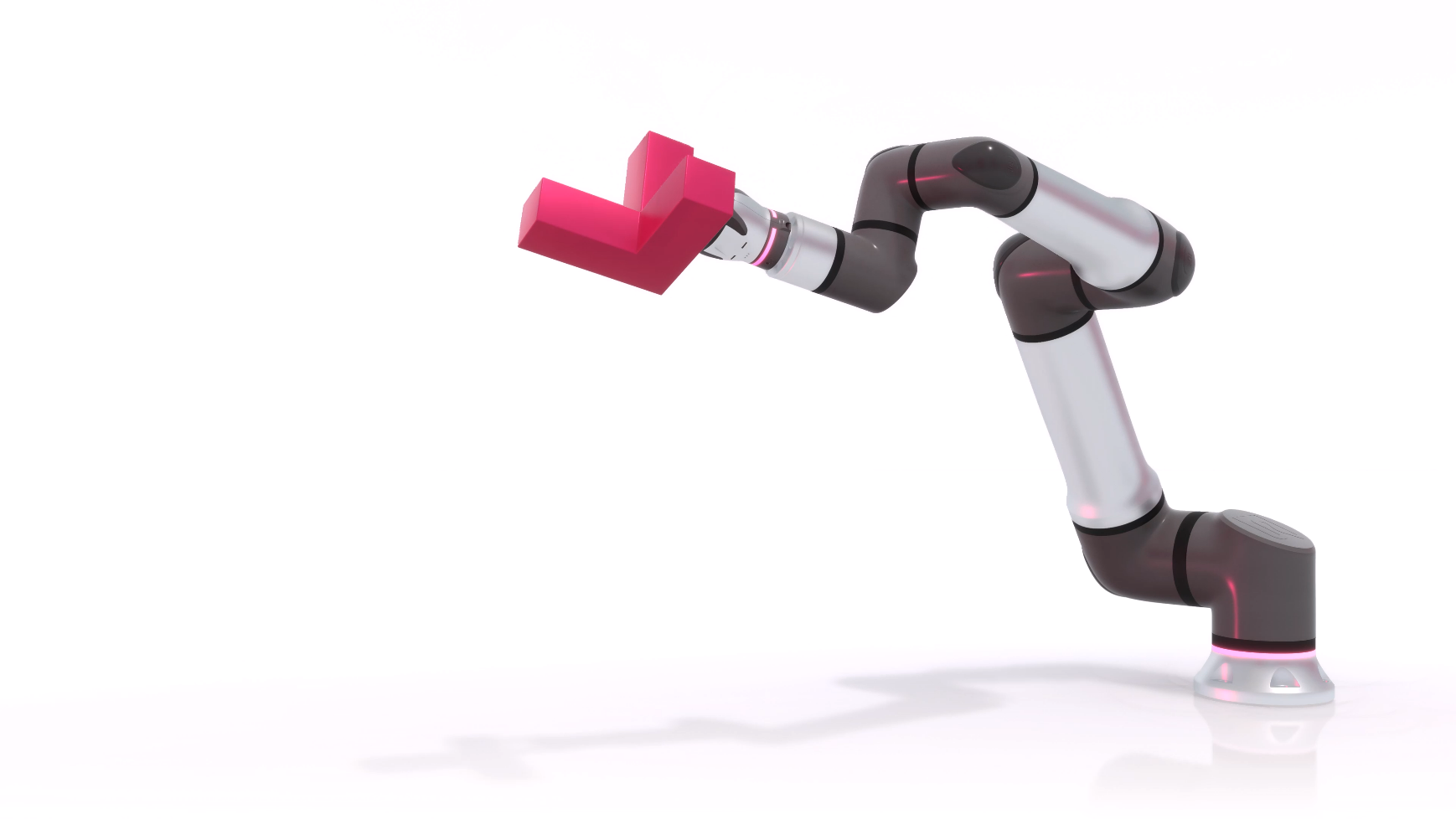

* **HDRP (High Definition Render Pipeline)**: Aimed at achieving top-tier visuals with sophisticated lighting and materials, HDRP is best for projects focused on marketing, sales applications, and rendered videos, requiring high-performance graphics cards.
<figure><img src="https://260262196-files.gitbook.io/~/files/v0/b/gitbook-x-prod.appspot.com/o/spaces%2FpYxFg97YnJX96UzNNTSd%2Fuploads%2Fgit-blob-dcd36c4631283d86099b23d19026c25dab1ae946%2Fimage.png?alt=media" alt=""><figcaption><p>UR30 robot in HDRP</p></figcaption></figure>

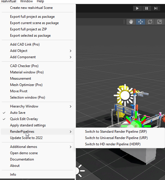

**Steps for Switching Render Pipelines:**
1. **Access Through Main Menu**: The option to switch render pipelines is available directly from the main menu `Tools > realvirtual > RenderPipelines`
2. **Backup Your Project**: It's crucial to create a backup of your project before proceeding with the switch. This precaution ensures that you can revert to your original settings should the need arise, preserving your work.
3. **Confirmation Prompt**: Upon initiating the switch, you'll receive a prompt confirming your decision. This process installs all necessary packages and updates the materials in your current scene, along with those in any packages and project materials, to be compatible with the selected pipeline.
<figure><img src="https://260262196-files.gitbook.io/~/files/v0/b/gitbook-x-prod.appspot.com/o/spaces%2FpYxFg97YnJX96UzNNTSd%2Fuploads%2Fgit-blob-ef0a69136a10c4c9308d0ac0e917ed47450d648f%2Fimage.png?alt=media" alt=""><figcaption></figcaption></figure>
