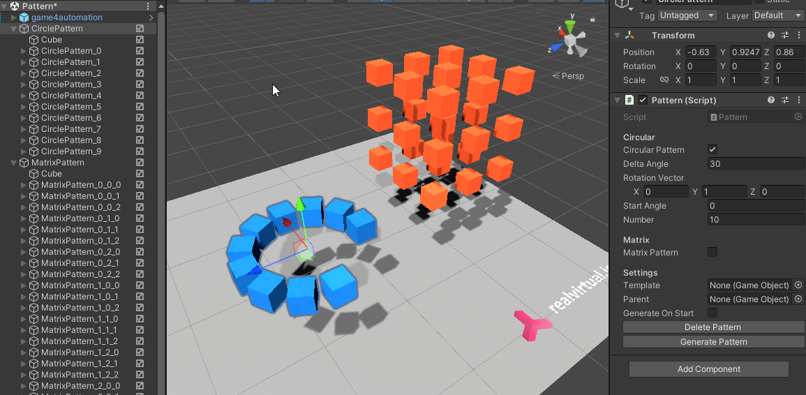

Pattern is an auxiliary component for creating circular matrix patterns. This can be used for example when you need to place many realvirtual.io components in a certain way (e.g. you need many fixers on a wheel with vacuum grippers). The pattern game objects are created based on a template and some geometric information about the spacing of the pattern components.
The pattern can be created in the editor mode or when starting the simulation.

## Properties <a href="#properties" id="properties"></a>
### Circular pattern
Creates a circular pattern. The center of rotation is always the center of rotation of the transformation to which the pattern component is attached.
#### Detla angle
The angle between the individual circular pattern components.
#### Rotation vector
The direction vector of the rotation.
#### Start angle
The start angle of the pattern.
#### Number
The number of the created pattern components.
### Matrix Pattern
Creates a matrix pattern.
#### Number X,Y,Z
The number of components of the pattern in the X, Y and Z directions.
#### Spacing X,Y,Z
The spacing of the pattern components in the x, y, and z directions.
### Settings
#### Template
If no template is defined, the component to which the pattern component is attached will be copied. It is recommended to define a template (referenced by this property) and disable the template itself (the pattern components are automatically enabled when they are created).
#### Parent
If no parent is defined, the pattern components are automatically created below the game object to which the pattern component is attached.
#### Create at startup
If true, the pattern components will be created when the simulation is started.
#### Delete pattern
Manually delete the pattern in editor mode.
#### Generate pattern
Generates the pattern in editor mode.
