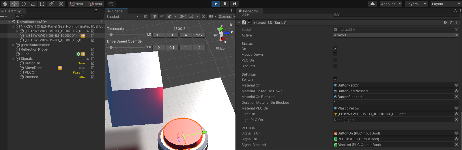

The Interact3D script alows you to define user interaction like pushbuttons, switches or opening of doors in the 3D scene. This script can be attached to any component with a collider. If the user is clicking on the object the status will change.
<figure><img src="https://260262196-files.gitbook.io/~/files/v0/b/gitbook-x-prod.appspot.com/o/spaces%2FpYxFg97YnJX96UzNNTSd%2Fuploads%2Fgit-blob-72148ef6c0d39157a3d4187473c48c70ed03bbbb%2Finteract3d.png?alt=media" alt=""><figcaption></figcaption></figure>
