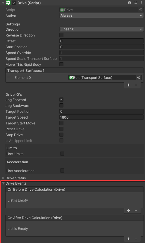

## Drive Events
The Drive has two key events that you can utilize to hook into its update sequence:
* **OnBeforeDriveCalculation:** This event is triggered before the Drive begins calculating its behavior models and updating its position. It's an ideal point to inject custom logic or make adjustments before the Drive's primary calculations occur.
* **OnAfterDriveCalculation:** This event is called after the Drive has completed all behavior model calculations and updated its position, but before any SubDrives are calculated. This allows you to make further modifications or perform actions right after the main Drive update but still within the overall update sequence.
By using these events, you can effectively integrate custom behavior or adjustments into the Drive's update process.
