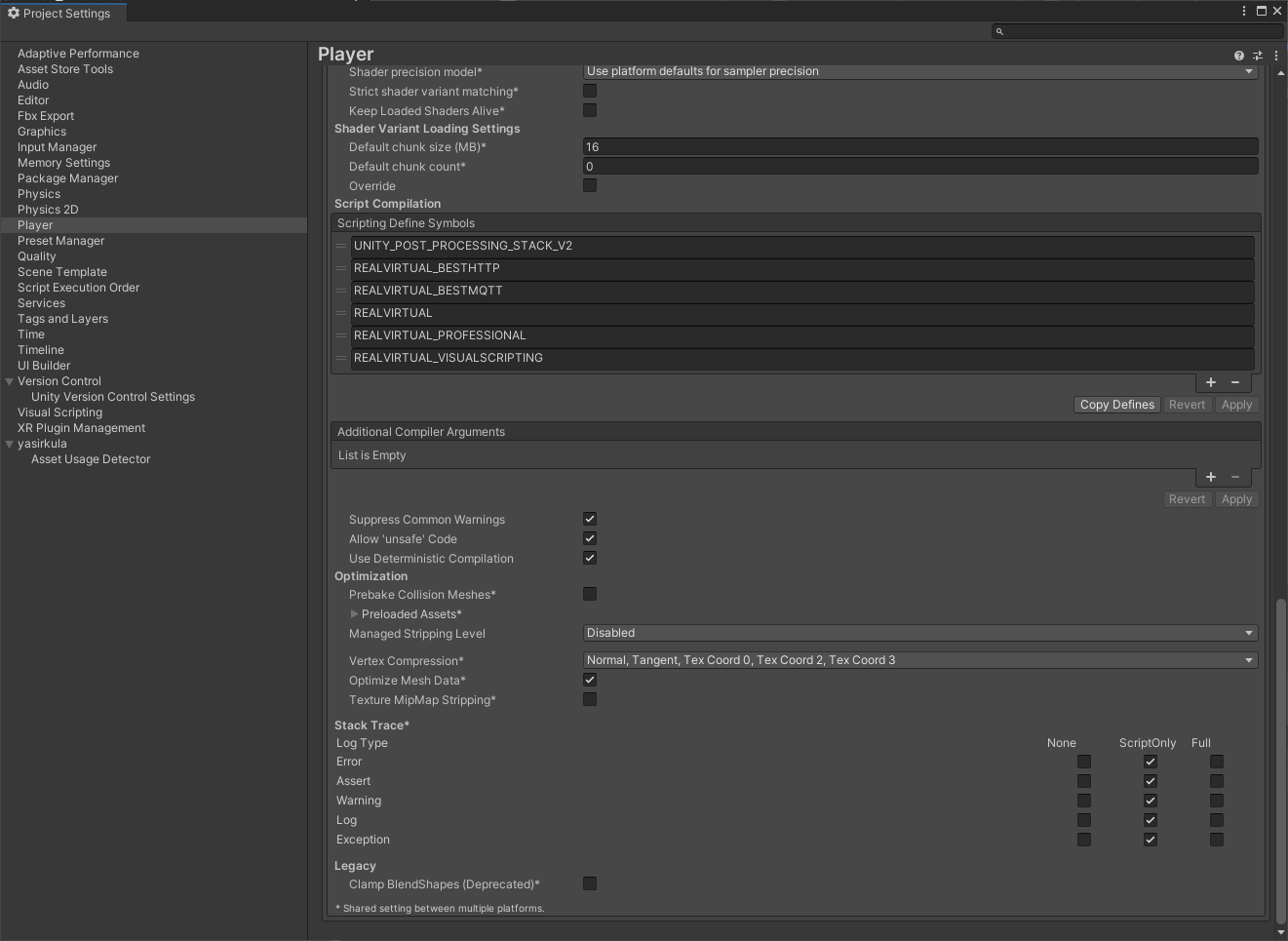

You can find the current compiler defines under *`File > Build Settings > Player Settings > Other Settings > Scripting Define Symbols:`*
<figure><img src="https://260262196-files.gitbook.io/~/files/v0/b/gitbook-x-prod.appspot.com/o/spaces%2FpYxFg97YnJX96UzNNTSd%2Fuploads%2Fgit-blob-b094cb835af56baa9b94a51ab6db654a7fce5364%2FrvPlayerSettings.png?alt=media" alt=""><figcaption><p><em><code>Compiler Defines (example setup - only use what is needed in your installation)</code></em></p></figcaption></figure>
