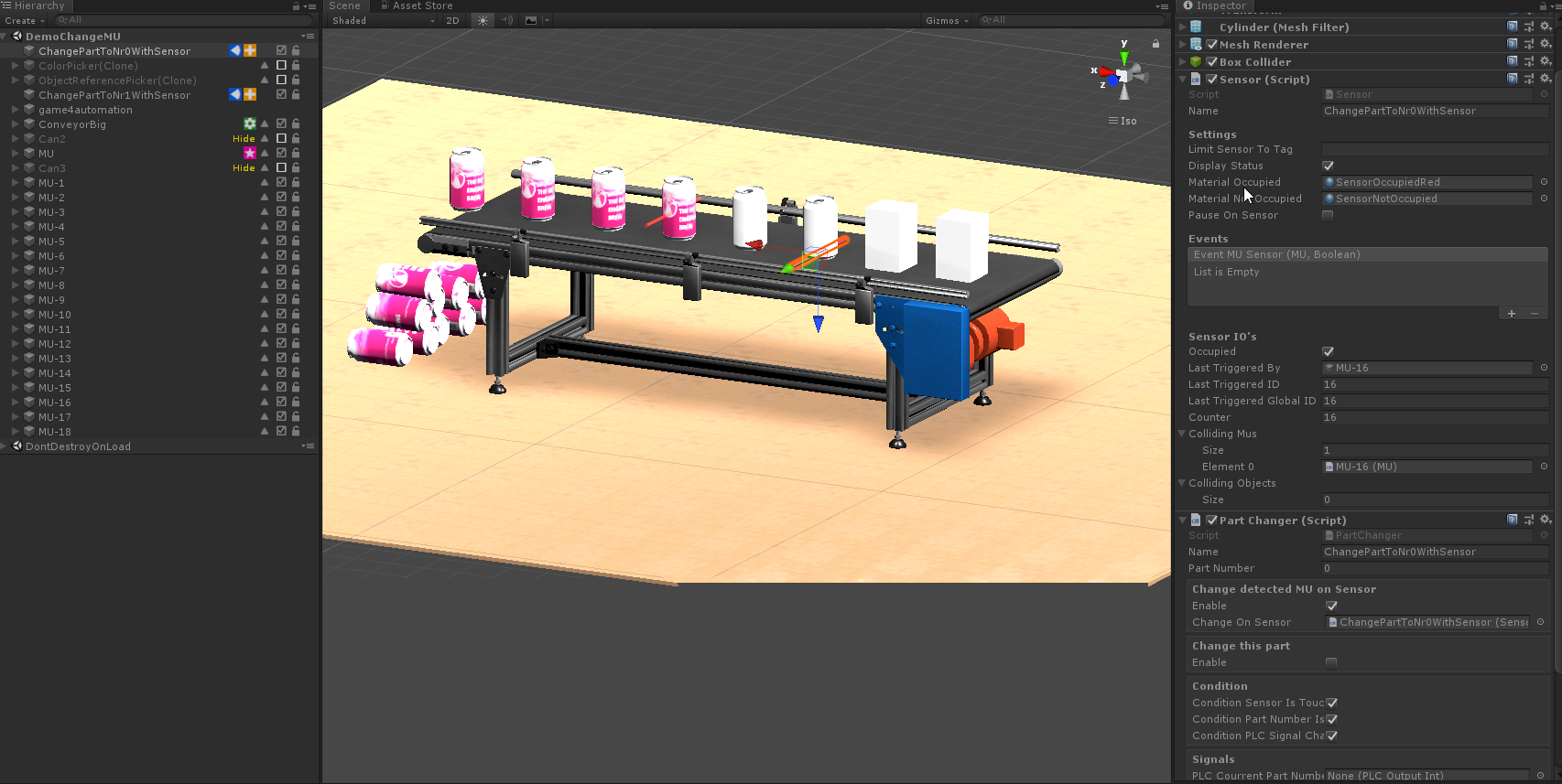

You can find a Demo scene for the PartChanger under Assets/realvirtual/Scenes/DemoChangeMU.unity
The part changer can change the visual appearance of the component where the part changer is attached to (*Change this part* option) or to change the visual appearance of an [MU](/components-and-scripts/mu-movable-unit.md) which is detected by a Sensor (*Change On Sensor* option)

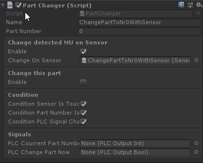

### Configuration of the PartChanger <a href="#configuration-of-the-partchanger" id="configuration-of-the-partchanger"></a>
You need to set a Part Number in the Part changer. This is the number, starting from 0, in the list of available Appearances. The list of available Appearances can be on the [MU](/components-and-scripts/mu-movable-unit.md) or on the PartChanger itself if no MU is changed.
#### Change detected MU on Sensor
Is changing the appearance of [MUs](/components-and-scripts/mu-movable-unit.md) which are entering the defined sensor.
#### Change this part
Is changing the appearance of the object where the PartChanger script is attached to. This means that the part changer needs to be attached to an MU.
#### Conditions
You can select a condition when the Part should be changed.
#### `Condition Sensor Is Touched`
This property allows the visual appearance of a part to change when a sensor detects a part. If set to true, the part will change as soon as the sensor touches an [MU](/components-and-scripts/mu-movable-unit.md).
#### `Condition Part Number Is Changing`
When enabled, this property changes the visual appearance of the part whenever the `PartNumber` value changes. This is useful for dynamically updating the appearance based on external triggers, such as updates from a PLC or other logic controllers.
#### `Condition PLC Signal Change`
If enabled, this property changes the part's visual appearance when the corresponding PLC signal (`PLCChangePartNow`) changes. This is especially useful when integrating with PLC systems to trigger a part change based on automation logic. The part will be updated each time the signal changes its state.
#### Signals
You can connect two PLC Signals. One for starting the visual change and one for selecting a new part number.
