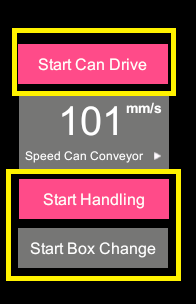

The HMI Switch works as toggle switching the connected Signal status between true and false. To use it with the render mode "Worldspace" you need the HMI-PanelWorldSpace as parent.
<div align="left"><figure><img src="https://260262196-files.gitbook.io/~/files/v0/b/gitbook-x-prod.appspot.com/o/spaces%2FpYxFg97YnJX96UzNNTSd%2Fuploads%2Fgit-blob-f1590e7edc406bd278c05fb76703e706f661b0d0%2FhmiSwitchExample.png?alt=media" alt=""><figcaption><p>Switches are used to start and stop<br>the can conveyor and the gantry.</p></figcaption></figure></div>

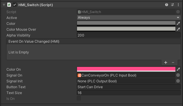

<div align="left"><figure><img src="https://260262196-files.gitbook.io/~/files/v0/b/gitbook-x-prod.appspot.com/o/spaces%2FpYxFg97YnJX96UzNNTSd%2Fuploads%2Fgit-blob-58969b1b3171eb799a780110e0fe9fb96bef68e9%2FHMISwitch.png?alt=media" alt=""><figcaption></figcaption></figure></div>
* `ColorOn` : color in case of Signal status true
* `SignalOn` : PLCInputBool signal connected to the Button
* `SignalInit` : PLCOutputBool signal for the value of the Switch when the application starts
* `Text`: Button text
* `Text Size` : font size
* `IsOn` : read only for the current state of the switch
