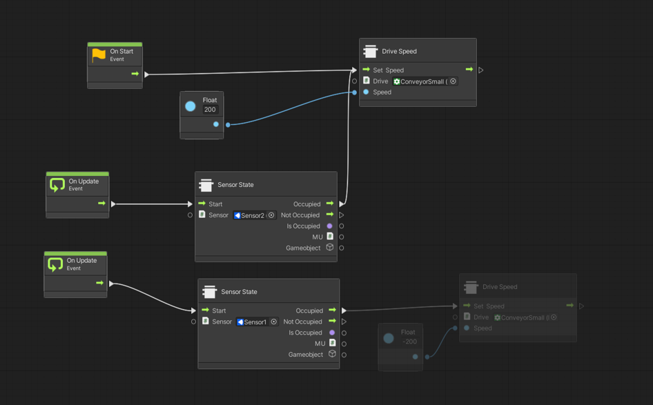

Unity’s Visual Scripting is a visual approach to programming. You can even track the status of the script during simulation. However, compared to the realvirtual.io LogicSteps alternative and to Playmaker, Unity Visual Scritping is less “step chain” oriented.
<figure><img src="https://260262196-files.gitbook.io/~/files/v0/b/gitbook-x-prod.appspot.com/o/spaces%2FpYxFg97YnJX96UzNNTSd%2Fuploads%2Fgit-blob-837c8223cf8c80c590d68572042c427b20116a95%2Funityvs_example.png?alt=media" alt=""><figcaption></figcaption></figure>

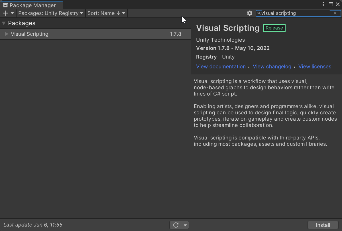

Unity Visual Scripting is an optional package and must be installed via the Unity Package Manager. You can search for “Visual Scripting” and you will find the latest package. Press “Install” to install the package.
<figure><img src="https://260262196-files.gitbook.io/~/files/v0/b/gitbook-x-prod.appspot.com/o/spaces%2FpYxFg97YnJX96UzNNTSd%2Fuploads%2Fgit-blob-fe74c0ed2bd3e4633750dc29ca1675e9635c2793%2Funityvs_packagemanager.png?alt=media" alt=""><figcaption></figcaption></figure>

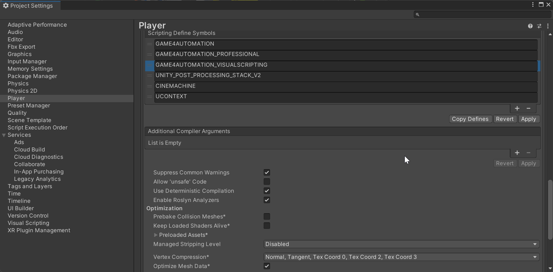

After Unity Visual Scripting is installed you need to set the compiler define. Please go to "Edit > ProjectSettings > Player > Other Settings". There you will find a section "Script Compilation - Scripting Define Symbols". Please add there "REALVIRTUAL\_VISUALSCRIPTING"
<figure><img src="https://260262196-files.gitbook.io/~/files/v0/b/gitbook-x-prod.appspot.com/o/spaces%2FpYxFg97YnJX96UzNNTSd%2Fuploads%2Fgit-blob-2f6b78528c2660f4ac23da6bb9fe856b7b27da3e%2Funityvs_symbols.png?alt=media" alt=""><figcaption></figcaption></figure>

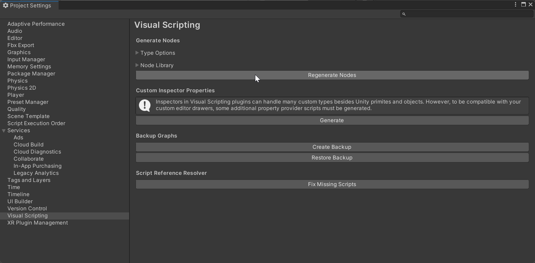

Now you will need to regenerate the visual scripting nodes by going to "Edit > ProjectSettings > VisualScripting". Please select "Regenerate Nodes"
<figure><img src="https://260262196-files.gitbook.io/~/files/v0/b/gitbook-x-prod.appspot.com/o/spaces%2FpYxFg97YnJX96UzNNTSd%2Fuploads%2Fgit-blob-741318210a76d88e81a783c1df3928f2740c9aa0%2Funityvs_regeneratenodes.png?alt=media" alt=""><figcaption></figcaption></figure>

All nodes have an event entry port on the left side. This port must be connected to an event sender node in order for the node’s logic to execute.
#### Drive Speed
This node sets the speed of the selected drive. The output event port is always executed once the input event port is set.
