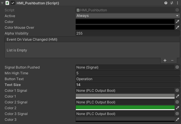

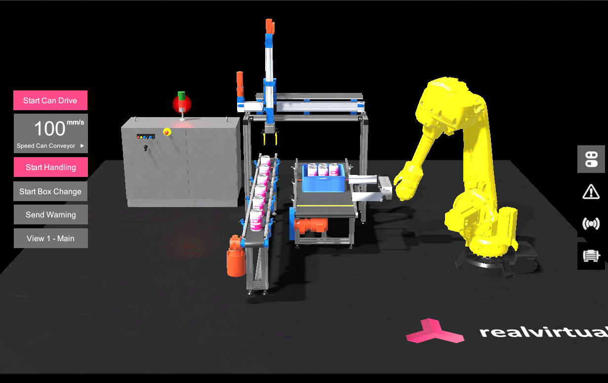

The HMI Pushbutton is used to set a signal for a certain time to high (boolean value true). To use it with the render mode "Worldspace" you need the HMI-PanelWorldSpace as parent.
Properties
SignalButtonPushed: signal which will be set by the buttonMin high Time: minimum high time of the signalButton text: free text which is shown within the buttonText Size:font size of the button textColor 1 SignaltoColor 3 Signaland Colors: the button can change the color depending on boolean Signals
