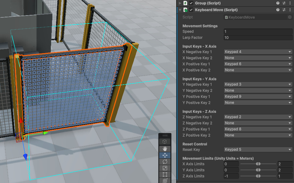

<figure><img src="https://260262196-files.gitbook.io/~/files/v0/b/gitbook-x-prod.appspot.com/o/spaces%2FpYxFg97YnJX96UzNNTSd%2Fuploads%2Fgit-blob-0af648bcd2788700a5ab7a4fb451399499a3e6b4%2Fkeyboard-move-inspector.png?alt=media" alt="KeyboardMove component in Unity Inspector"><figcaption><p>KeyboardMove component in Unity Inspector</p></figcaption></figure>

When the GameObject with KeyboardMove is selected in the Unity Editor, cyan wireframe boundaries visualize the allowed movement area. This wireframe cube shows the exact limits defined by the axis limit properties, making it easy to understand and adjust the movement constraints.
A yellow sphere marks the initial position (center point) of the movement area, providing a clear reference for the origin of all movement calculations. During play mode, a red sphere indicates the current target position, helping debug movement behavior and verify that limits are working correctly.
