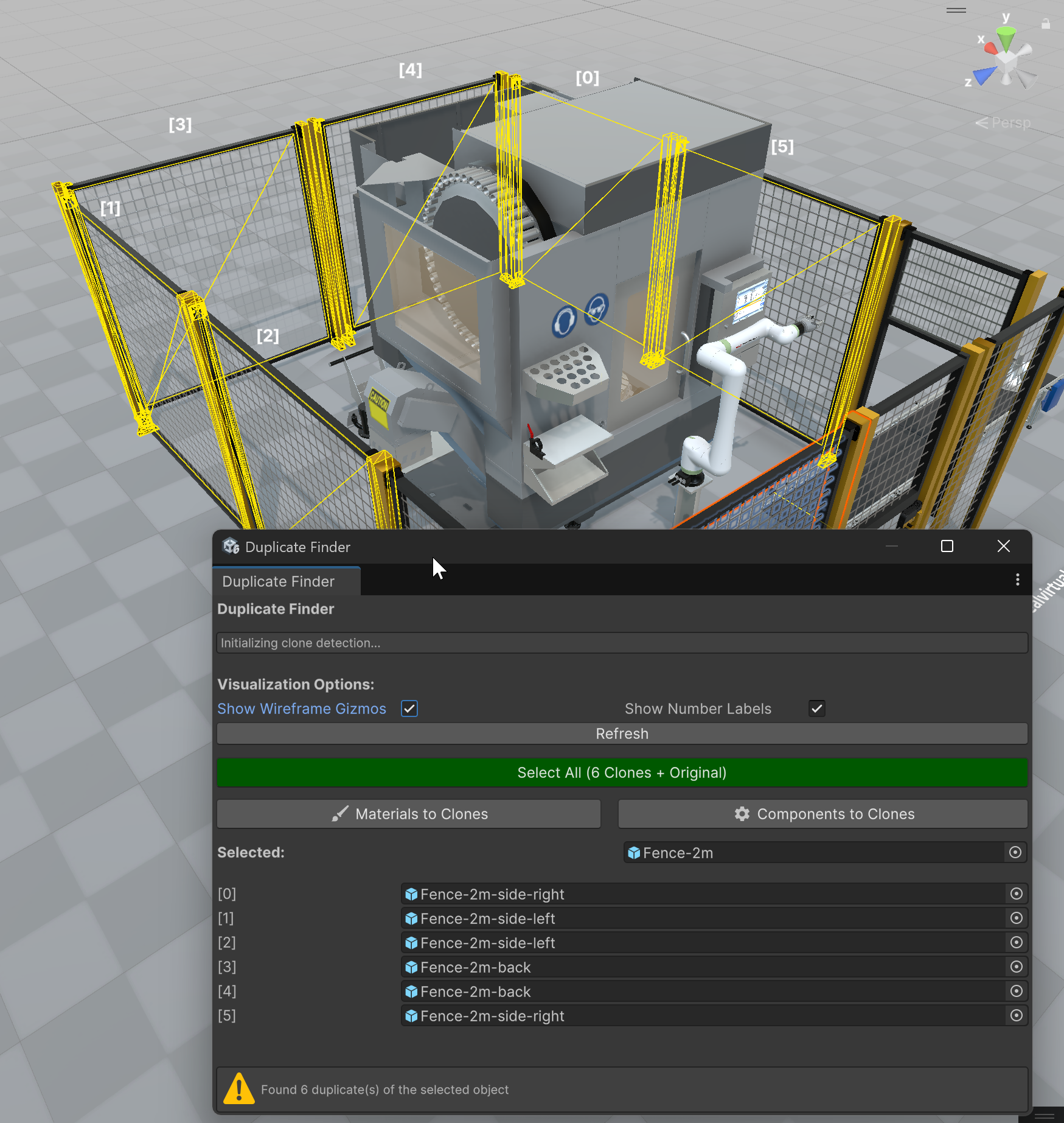

<figure><img src="https://260262196-files.gitbook.io/~/files/v0/b/gitbook-x-prod.appspot.com/o/spaces%2FpYxFg97YnJX96UzNNTSd%2Fuploads%2Fgit-blob-c8e1e7880d14e10f785d0df848ab5fa1d9cd8c56%2Fduplicate-finder-window.png?alt=media" alt=""><figcaption><p>Duplicate Finder window showing 6 clones of a fence object with scene visualization</p></figcaption></figure>

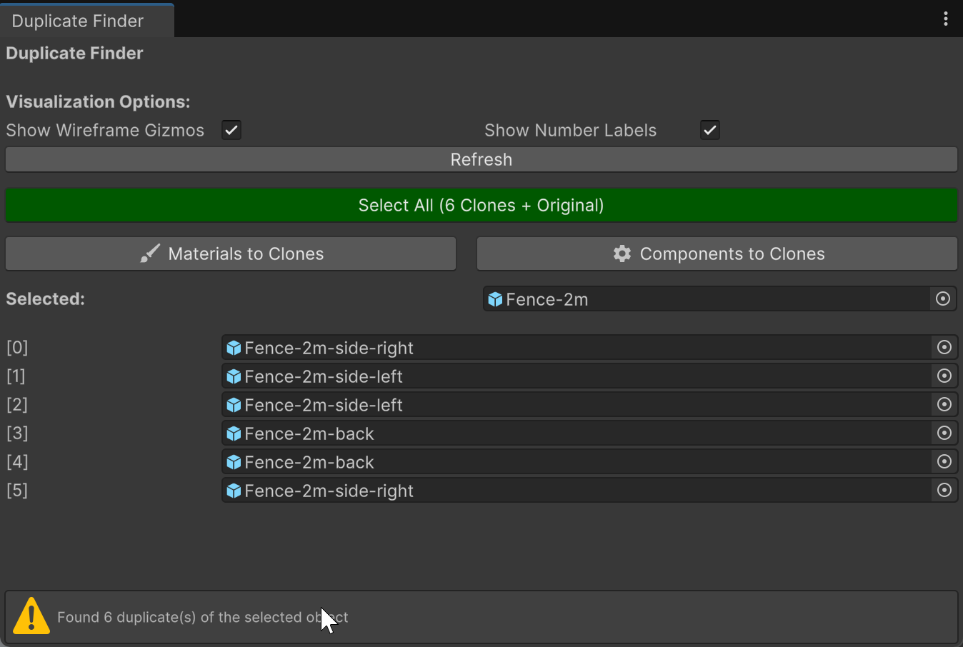

<figure><img src="https://260262196-files.gitbook.io/~/files/v0/b/gitbook-x-prod.appspot.com/o/spaces%2FpYxFg97YnJX96UzNNTSd%2Fuploads%2Fgit-blob-809982b5b3024adf9b20eb8b1338eef87521d46f%2Fduplicate-finder-interface.png?alt=media" alt=""><figcaption><p>Duplicate Finder interface showing visualization options, action buttons, and clone list</p></figcaption></figure>
The Duplicate Finder window is organized into several sections:
### Visualization Options
* **Show Wireframe Gizmos** (checkbox) – Display yellow wireframe outlines around duplicate objects in scene view
* **Show Number Labels** (checkbox) – Show numeric labels \[0], \[1], \[2], etc. above each duplicate instance
* **Refresh** (button) – Recalculates mesh hashes and updates duplicate detection
### Action Buttons
* **Select All (X Clones + Original)** (green button) – Selects all duplicate objects plus the original in the scene hierarchy. The button displays the total count dynamically.
* **Materials to Clones** (button with brush icon) – Copies all materials from the selected object to all detected clones
* **Components to Clones** (button with gear icon) – Copies all components from the selected object to all detected clones
### Clone List
* **Selected Object** – Shows the currently selected object name at the top (highlighted with blue cube icon)
* **Numbered Clones** – Lists all detected duplicates with sequential numbers \[0], \[1], \[2], \[3], etc.
* **Object Names** – Displays the GameObject name for each clone with blue cube icon
* **Navigation Icons** – Click the circle icon on the right to select and navigate to that object in the hierarchy
### Status Display
At the bottom of the window, a yellow warning triangle displays: **"Found X duplicate(s) of the selected object"**
